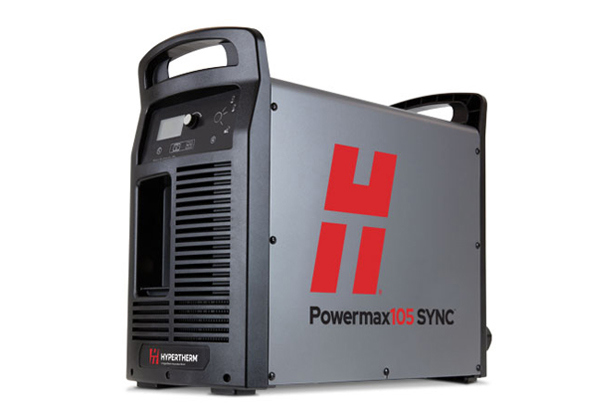

Powermax105 SYNC plasma cutter
The Powermax105 SYNC® is a next-generation, professional-grade air plasma cutter that dramatically simplifies system operation for gouging and recommended cutting up to 32 mm (1-1/4″). Features automated system process set-up via advanced RFID-enabled SmartSYNC® torches, and a revolutionary single-piece cartridge that provides trackable utilization data. The Powermax105 SYNC maximizes productivity through reductions in downtime, optimized cut quality performance, and streamlined consumable inventory management.

Benefits
Easy to use
  • Cartridges are easy to identify by process with clear laser marking and color coding to eliminate part mix-ups.
  • RFID-enabled SmartSYNC torches and cartridges automatically set the correct amperage and operating mode, eliminating setup errors.
  • End-of-life consumable detection eliminates the uncertainty of knowing when to change the cartridge.
  • Less operator fatigue when using hand torches with our new flexible lead. The lead has the same robustness of our previous lead jacket material and will also be used on robotic torches.
Cartridge reader and RFID
Minimize operation costs
  • Simplified system operation minimizes the time and costs spent on training and troubleshooting.
  • Reductions to downtime during consumable change-outs and elimination of costs associated with premature disposal of consumable parts.
  • Cartridge usage data provides valuable insights for improving cutting operations and consumable inventory management.
Maximize performance
  • Tackle a wide range of jobs with easily interchangeable torch styles and application specific cartridges for various types of cutting and gouging.
  • Optimized cartridge consumable design provides up to twice the life for handheld cutting and improved quality over life in mechanized setups compared to standard consumables.
  • Time-saving hand torch controls allow the operator to adjust the amperage on the fly, change cartridges and applications without returning to the power supply.
Industry-leading reliability
  • SmartSYNC torches are engineered for rugged, industrial environments.
  • SpringStart™ technology ensures consistent starting and a more reliable torch.
  • Industry-leading reliability reduces production downtime.
Specifications
Cut and gouge capacities
Cut capacity Thickness Cut speed
Recommended 32 mm (1-1/4″) 500 mm/min (20 ipm)
  38 mm (1-1/2″) 250 mm/min (10 ipm)
Severance (hand cutting) 50 mm (2″) 125 mm/min (5 ipm)
Pierce* 22 mm (7/8″)
*Pierce rating for handheld use or with automatic torch height control
Gouge capacity Metal removal rate Groove profile
Typical gouge 8,6 kg (19.1 lbs.) per hour 6,6 mm D x 6,0 mm W (0.26″ D x 0.24″ W)
General specifications
Specifications - CSA
Input voltages (± 10%)
200–600 V, 3-PH, 50/60 Hz
Input current @ 16.8 kW
200/208/240/480/600 V, 3-PH 58/56/49/25/22 A
Output current
30–105 A
Rated output voltage
160 VDC
Duty cycle @ 40° C (104° F)
70% @ 105 A, 240 V, 3-PH
80% @ 105 A, 480–600 V, 3-PH
100% @ 94 A, 480–600 V, 3-PH
100% @ 88 A, 240 V, 3-PH
Open circuit voltage (OCV)
300 VDC
Weight with 7,6 m (25′) torch
230-400 V: 42.7 kg (94 lbs.)
Specifications - CE/CCC
200-600 V, 3-PH, 50/60 Hz
380-400 V, 3-PH, 50/60 Hz
Output current
30–105 A
160 VDC
80% @ 105 A, 400 V, 3-PH
100% @ 94 A, 400 V, 3-PH
100% @ 88 A, 230 V, 3-PH
288 VDC
39.4 kg (87 lbs.)
CE – for use in Europe, Australia & New Zealand - RCM, Serbia, UK – UKCA, Ukraine, and other countries where accepted. CCC – for use in China.
Dimensions with handles
592 mm D; 274 mm W; 508 mm H (23.3″ D; 10.8″ W; 20.0″ H)
Gas supply
Clean, dry, oil-free air or nitrogen
Recommended inlet gas flow rate
Cutting: 260 I/min @ 6.2 bar (550 scfh, 9.1 scfm @ 90 psi)
Gouging: 260 I/min @ 4.8 bar (550 scfh, 9.1 scfm @ 70 psi)
Input power cable length
3 m (10′)
Power supply type
Inverter–IGBT
Engine drive requirement
30 kW or 37.5 kVA for full 105 A output
Electrical efficiency
91%
Recyclability
100%
Warranty
Power supply: 6-year, Torch: 1-year

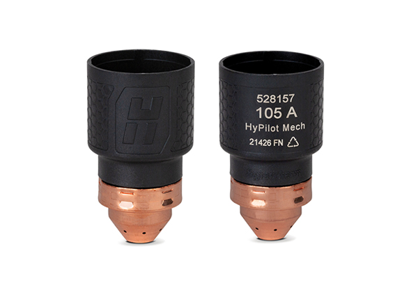

Hypertherm Cartridges
Hypertherm cartridges
Process
Cartridge
105 A
428937
85 A
428935
65 A
428931
45 A
FineCut® hand cutting
Drag cartridge:
FineCut cartridge:
Process
Cartridge
105 A
428936
85 A
428934
65 A
428930
45 A
FineCut® mechanized cutting
Ohmic ring kit
428895
Process
Cartridge
Max removal gouging 105 A
428938
Max removal gouging 45–85 A
428932
Max control gouging 105 A
428939
Max control gouging 45–85 A
428933
FlushCut options
FlushCut
Process
FlushCut™
105 A
428954
85 A
428953
65 A
428952
HyAccess options
HyAccess cartridges
Process
HyAccess™
Drag cutting 65 A
428984
Gouging 65 A
428987
Mechanized cutting 65 A
528079
HyPilot for mechanized cutting
HyPilot cartridge for mechanized cutting
Process
HyPilot
Mechanized cutting 105 A
528157
