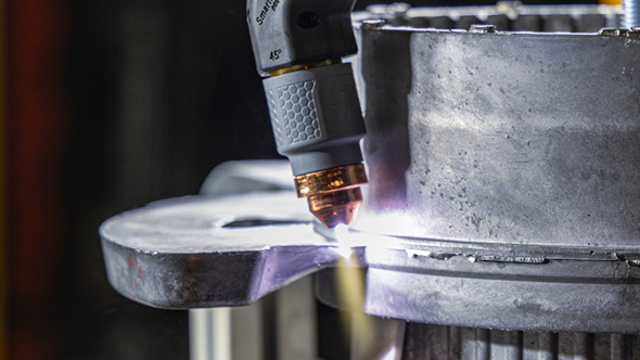

Plasma Cast Trimming Reduces Workplace Injuries and Increases Throughput
Plasma cast trimming provides metal fabricators with a significantly safer and healthier work environment, reducing workplace injuries.
Degating casts with plasma also:
Increases efficiency and cut quality
Improves productivity
Builds operator skillsets
Boosts job satisfaction
Foundries Gain Competitive Advantage Cast Trimming with Plasma
Plasma cutting significantly reduces cycle times by quickly and accurately removing excess material from castings, resulting in higher productivity and less downtime. Plasma technology handles a variety of cast materials and thicknesses and allows for easy adjustments and quick changes in the trimming process. Additionally, integrating plasma cutting with cobots and industrial robots minimizes reliance on skilled labor, increases productivity, and reduces workplace injuries and labor costs.

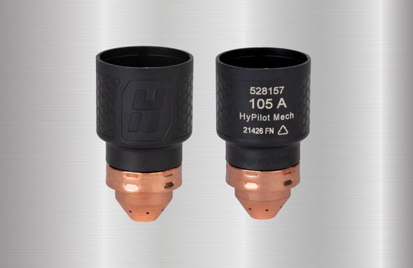

Advanced Plasma Consumables for Robotic Cast‑Trimming Applications
Robotic cast trimming demands consumables that can withstand long pilot‑arc times, high stand‑off heights, and continuous 3D motion. The new HyPilot cartridge—engineered with patent‑pending NickelPlus technology—is purpose‑built for these applications, delivering up to six times the life of standard copper nozzles, reducing operating costs, and extending uptime. Designed specifically for robotic and cobot plasma cutting, HyPilot minimizes wear during prolonged pilot arcing and supports casting manufacturers transitioning away from trim presses and slower mechanical methods. The result is a more flexible and cost‑effective cast-trimming solution that lowers the total cost of ownership while maintaining productivity and performance.
