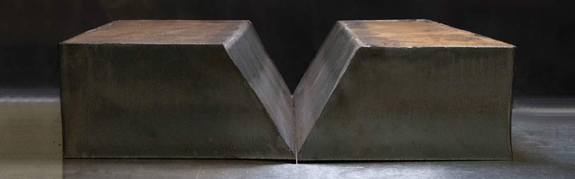

High definition beveling with True Bevel technology

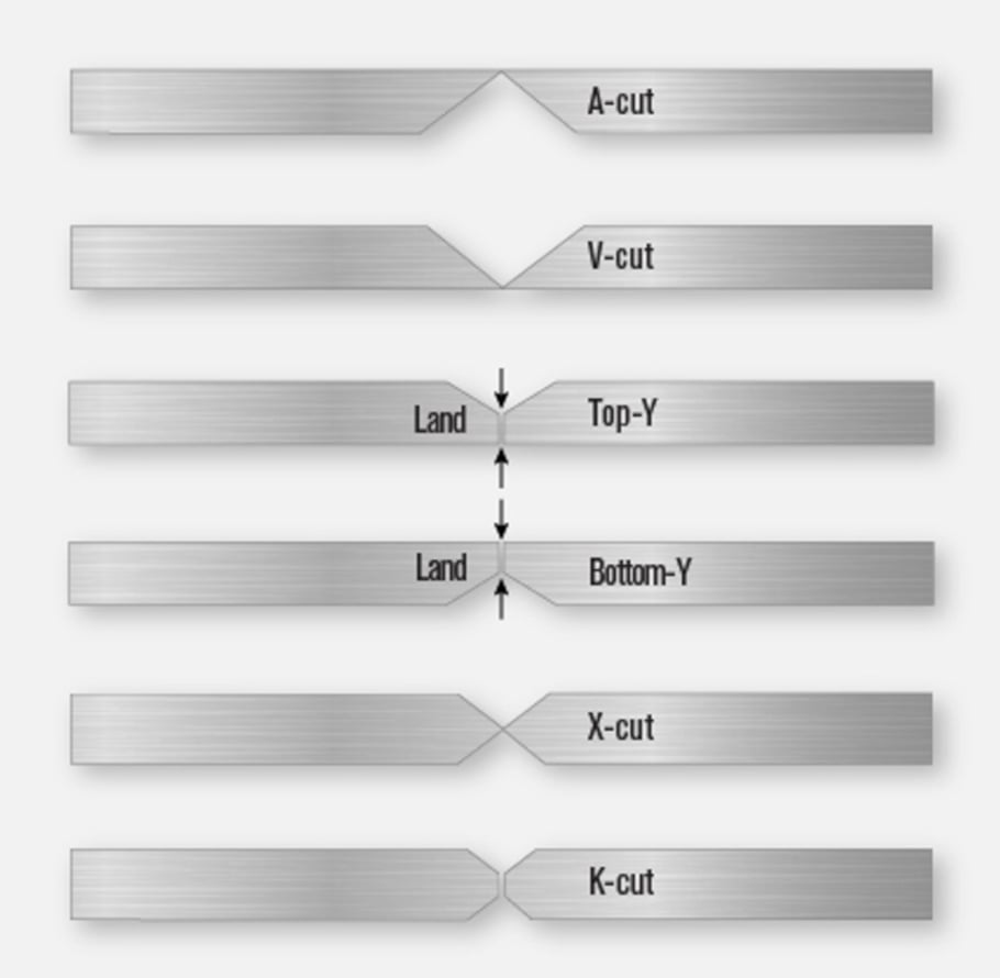

As part of Hypertherm's SureCut™ technology, True Bevel™ technology for HPR®XD and XPR® plasma systems eliminates costly trial and error setup and secondary operations because the most common setup values for mild steel have already been determined in the cut charts for a wide variety of thicknesses and every amperage for V, A, and top Y bevel cuts. And they've been factory tested. A beveling process taking two to three hours of unproductive labor can now be completed in 10 minutes with True Bevel technology.

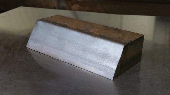

Cut sample using True Bevel technology
  • 1 iteration
  • Using True Bevel
  • Acceptable part and ready to start production

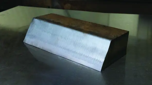

Cut sample without using True Bevel technology
  • 3 iterations
  • Existing method which took more than 1 hour to complete
  • Not acceptable, at least 1 further iteration will be required

  3. If not to specification, the operator calls in a programmer to examine the part and adjust the program, dialing in the angle, land size, or part dimensions

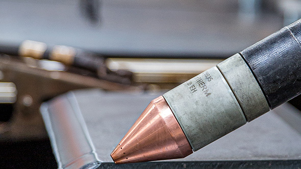

XPR plasma
XPR® embedded process technology improves 45° bevel cut quality on thick material up to 50 mm (2″). Bevel cutting with high definition plasma makes the welding process more efficient, eliminating costly trial and error setup. It improves the speed, repeatability, and accuracy of bevel cutting.
XPR plasma’s high cut quality results in consistent, perfect geometries and dross-free cuts, resulting in weld-ready bevels with little or no need for secondary grinding.

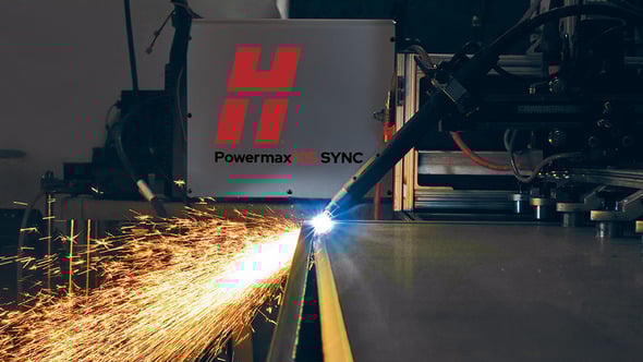

Powermax plasma
Powermax® plasma technology with an optimized track/carriage solution can deliver cutting speeds up to 4 times faster than oxyfuel on 12 mm (1/2″) mild steel. Plasma is faster and easier to set-up, has a smaller overall footprint, and a smoother cut edge so significantly less grinding is required prior to welding.
SmartSYNC® torches with the Hypertherm cartridge tackle diverse jobs with easily interchangeable torch styles and application-specific cartridge consumables for varied cutting, gouging, and beveling applications.

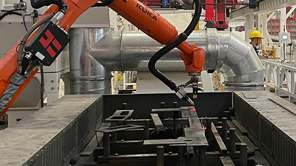

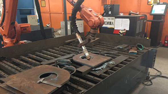

Robotic beveling
Robotic beveling is the most flexible method, consolidating multiple operations, such as handling, cutting, marking, grinding, welding, and completing parts in one cell. Combined with off-line programming and embedded technology expertise, this enables high mix/low volume capability, with minimal labor requirements.
When compared to robotic oxyfuel beveling, robotic plasma beveling is over 3 times more efficient and provides a comprehensive cost of 3 to 4 times lower.
