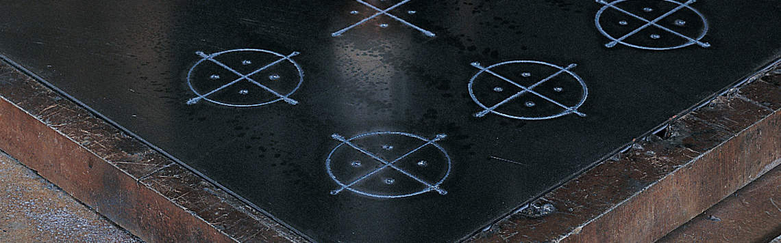

Fabricators and manufacturers routinely mark metal to indicate bend or score lines and add precise technical information to parts such as part numbers and barcodes. Typically, this work is performed manually using a hammer and punch, powder or ink, soapstone, handheld engraving machines, or as an integral process step on a mechanized plasma or oxyfuel cutting table.
Choosing to mark with plasma – whether using a handheld torch or mechanized cutting table, has several advantages, such as marking with plasma being more permanent than soapstone or ink. In addition, the precise nature of marking done during CNC cutting process is more accurate and legible, with depth precisely controlled to determine whether marks remain visible or not after coatings are applied.
Marking with plasma can be used on wet or oily plate, and eliminates the clogging problems and humidity concerns associated with powder marking, and is safer, faster, and more accurate than marking with ink or with a hammer and punch. The versatility of the portable Powermax45®â€¯XP plasma system makes it an ideal tool for both handheld and mechanized marking applications, and for making temporary or permanent marks on metal surfaces such as mild steel, stainless steel, or aluminum.
When fully mechanized systems, such as the HPR®â€¯or XPR™, are equipped with both a cutting head and marking hardware, fabricators can consolidate cutting and marking into a single-pass operation for increased productivity.
Scoring to indicate cut or weld lines
Product or part identification
Creating position references for robotic systems
Creating dimples to start drilling holes
