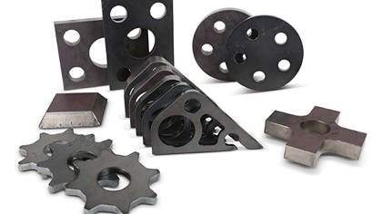

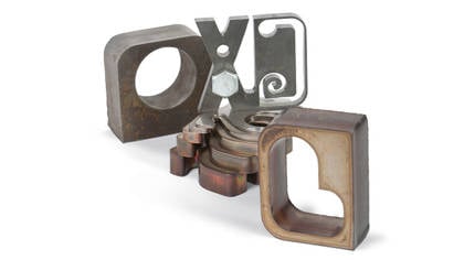

Industry-leading cut quality – X-Definition
  • Improves cut quality and consistency (cut angularity) through the life of the consumables
  • Delivers superior cut quality for cutting stainless steel and cutting aluminum across the thickness ranges providing cleaner, sharper, and more consistent edge quality

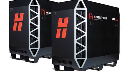

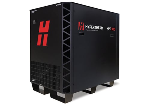

XPR system differences

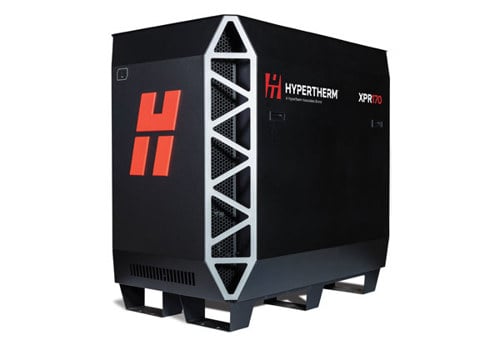

XPR170
  • Maximum power output: 170 amps
  • Optimal cut quality thicknesses: 3 mm to 35 mm (1/8″ to 1-3/8″)
  • Cut speed for 20 mm (3/4″) at 170 A:  1,575 mm/min (65 in/min)
  • Pierce capacity: 40 mm (1-9/16″)
  • Severance capacity: 60 mm (2-3/8″)
XPR300
  • Maximum power output: 300 amps
  • Optimal cut quality thicknesses: 3 mm to 45 mm (1/8″ to 1-7/8″)
  • Cut speed for 20 mm (3/4″) at 300 A: 2,550 mm/min (105 in/min)
  • Pierce capacity: 50 mm (2″)
  • Severance capacity: 80 mm (3-1/8″)
XPR460
  • Maximum power output: 460 amps
  • Optimal cut quality thicknesses: 3 mm to 50 mm (1/8″ to 2″)
  • Cut speed for 20 mm (3/4″) at 460 A: 3,140 mm/min (129 in/min)
  • Pierce capacity: 64 mm (2.5″)
  • Severance capacity: 102 mm (4″)

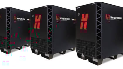

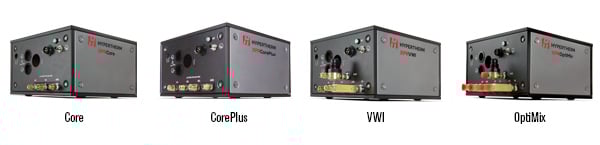

Gas console options for XPR
XPR console optionsType of metals being cut and expected quality outcomes will determine what gas console better fits your needs.
Core™
The Core console is designed for customers that cut mostly mild steel. The Core console offers full X-Definition capability on mild steel and entry-level capability on stainless steel and aluminum through the use of nitrogen as its plasma gas. The Core is capable of marking with nitrogen plasma gas on all materials.
CorePlus™
The CorePlus console is designed for customers that cut mostly mild steel. Like the Core, the CorePlus console offers full X-Definition capability on mild steel and entry-level capability on stainless steel and aluminum through the use of nitrogen as its plasma gas. This includes very good results on thin stainless steel through Hypertherm’s HDi cutting process.  The CorePlus is capable of marking with argon plasma gas on all materials and provides thicker material piercing using argon-assist technology.
Vented Water Injection™ (VWI™)
The VWI console is designed for customers whose volume is predominantly mild steel but who require improved capability for cutting stainless steel and aluminum, thicker piercing capability, or high-quality marking. The VWI console offers all the benefits of the Core console plus:
  • Patent pending VWI processes which utilize a water-injection shield yielding excellent cutting outcomes on stainless steel and aluminum
  • F5 fuel gas capability delivering superior results on thinner stainless steel compared to nitrogen cutting
  • Argon gas capability offers exceptional marking results and increased pierce thickness capacity when using argon-assist cut processes
OptiMix console cut sample
OptiMix™
The Optimix console is designed for customers that cut a high volume of stainless steel and aluminum and who require the highest cutting outcomes for these applications. The Optimix console offers all the benefits of the VWI console plus the ability to mix up to three discrete gases:
  • Reduces the cost of purchasing pre-mixed fuel gasses like H35
  • Offers the flexibility to adjust gas mixtures to optimize stainless steel and aluminum cutting outcomes
