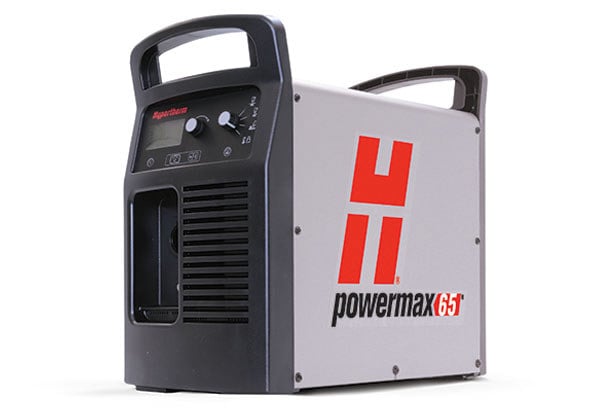

Powermax65 plasma cutter
The Powermax65® 65-amp plasma power supply will stop manufacturing in December 2021, and will no longer be available for sale from Hypertherm. We continue to make original replacement torches, consumables, and repair parts. Refer to the Torches and consumables section for additional upgrade options.
Hypertherm Technical Service department still supports this model.

Specifications
Cut capacity
Capacity Thickness Cut speed
Cutting
Recommended 20 mm (3/4″) 500 mm/min (20 ipm)
  25 mm (1″) 250 mm/min (10 ipm)
Severance (hand cutting) 32 mm (1-1/4″) 125 mm/min (5 ipm)
Pierce * 16 mm (5/8″)
* Pierce rating for handheld use or with automatic torch height control.
Capacity Metal removal rate Groove profile
Gouging
Typical gouge 4,8 kg/hr (10.7 lbs./hr) 3,5 mm D x 6,6 mm W (0.14″ D x 0.26″ W)
