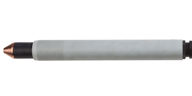

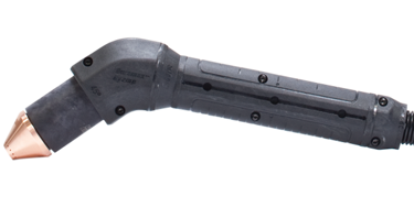

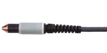

Torch and cable options
Duramax Hyamp torch options
| Hand torches | Machine torches | |||
| Cable length | 85° | 15° | 180° | Mini 180° |
| 4,5 m (15′) | 059519 | 059514 | ||
| 7,6 m (25′) | 059492 | 059495 | 059520 | 059515 |
| 10,7 m (35′) | 059521 | 059516 | ||
| 15,2 m (50′) | 059493 | 059496 | 059522 | 059517 |
| 22,8 m (75′) | 059494 | 059497 | 059523 | |
| 45,7 m (150′)* | 059665 | 059664 | 059666 | |

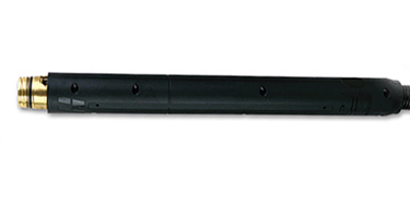

| Robotic torches | |||
| Cable length | 45° | 90° | 180° |
| 7,6 m (25′) | 059564 | 059565 | 059566 |
| 15,2 m (50′) | 059670 | 059671 | 059672 |
| Long torches | ||||||
| Cable length | 0,6 m (2′), 45° | 0,6 m (2′), 90° | 1,2 m (4′), 45° | 1,2 m (4′), 90° | 1,8 m (6′), 45° | 1,8 m (6′), 90° |
| 7,6 m (25′) | 059562 | 059563 | 059567 | 059568 | 059758 | 059623 |
| 15,2 m (50′) | 059579 | 059580 | 059581 | 059582 | 059759 | 059624 |
| 45,7 m (150′)* | 059667 | 059668 | ||||
