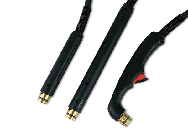

Torch and cable options
Duramax Hyamp torch options
  Hand torches Machine torches Robotic torches Long torches
Cable length 85° 15° 180° Mini 180° 45° 90° 180° 0,6 m (2′),45° 0,6 m (2′),90° 1,2 m (4′),45° 1,2 m (4′),90°
4,5 m (15′)     059519 059514
7,6 m (25′) 059492 059495 059520 059515 059564 059565 059566 059562 059563 059567 059568
10,7 m (35′)     059521 059516
15,2 m (50′) 059493 059496 059522 059517       059579 059580 059581 059582
22,8 m (75′) 059494 059497 059523
45,7 m (150′)* 059665 059664   059666       059667   059667

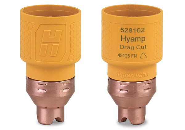

Hyamp drag cutting cartridges
Hypertherm cartridges
Process
Cartridge
Hyamp
528162
105 A
428937
85 A
428935
65 A
428931
45 A
FineCut hand cutting
Replaces this stack-up
Shield
Retaining cap
Nozzle
Electrode
Swirl ring
420000
220977
 220975
220971
220997
220992
220854
220990
220842
220994
220818
220816
220857
220819
220941
220931
220930
220947

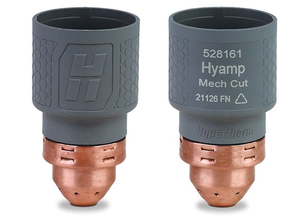

Hyamp mechanized cartridge
Process
Cartridge
Hyamp
528161
105 A
428936
85 A
428934
65 A
428930
45 A
