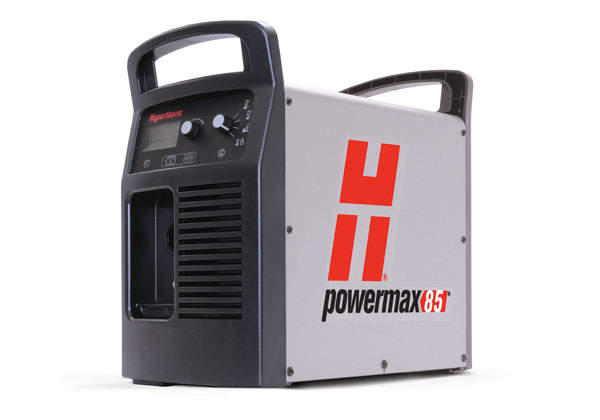

Powermax85 plasma cutter
The Powermax85® 85-amp plasma power supply will stop manufacturing in December 2021, and will no longer be available for sale from Hypertherm. We continue to make original replacement torches, consumables, and repair parts. Refer to the Torches and consumables section for additional upgrade options.
Hypertherm Technical Service department still supports this model.

Specifications
| Input voltages | CSA | 200–480 V, 1-PH, 50/60 Hz 200–600 V, 3-PH, 50/60 Hz |
| CE | 380/400 V, 3-PH, 50/60 Hz | |
| Input current @12.2 kW | CSA | 200/208/240/480 V, 1-PH, 70/68/58/29 A 200/208/240/480/600 V, 3-PH, 42/40/35/18/17 A |
| CE | 380/400 V, 3-PH, 20.5/19.5 A | |
| Output current | 25–85 A | |
| Rated output voltage | 143 VDC | |
| Duty cycle @ 40°C (104°F) | CSA | 60% @ 85 A, 230–600 V, 3-PH 60% @ 85 A, 480 V, 1-PH 50% @ 85 A, 240 V, 1-PH 50% @ 85 A, 200–208 V, 3-PH 40% @ 85 A, 200–208 V, 1-PH 100% @ 66 A, 230–600 V, 1/3-PH |
| CE | 60% @ 85 A, 380/400 V, 3-PH 100% @ 66 A, 380/400 V, 3-PH |
| Open circuit voltage (OCV) | CSA | 305 VDC |
| CE | 270 VDC | |
| Dimensions with handles | 500 mm (19.7") D; 234 mm (9.2") W; 455 mm (17.9") H | |
| Weight with 7.6 m (25') torch | CSA | 32 kg (71 lbs.) |
| CE | 28 kg (62 lbs.) | |
| Gas supply | Clean, dry, oil-free air or nitrogen | |
| Recommended gas inlet flow rate/pressure |
Cutting: 189 l/min (400 scfh, 6.7 scfm) @ 5.9 bar (85 psi) Gouging: 212 l/min (450 scfh, 7.5 scfm) @ 4.8 bar (70 psi) |
| Input power cable length | 3 m (10') | |
| Power supply type | Inverter – IGBT | |
| Engine drive rating | System output current | Performance (arc stretch) |
| 20 kW | 85 A | Full |
| 15 kW | 70 A | Limited |
| 15 kW | 60 A | Full |
| 12 kW | 60 A | Limited |
| 12 kW | 40 A | Full |
| 8 kW | 40 A | Limited |
| 8 kW | 30 A | Full |
Cut capacity
| Capacity | Thickness | Cut speed |
Cutting |
| Recommended | 25 mm (1") | 500 mm/min (20 ipm) |
| 32 mm (1-1/4") | 250 mm/min (10 ipm) | |
| Severance (hand cutting) | 38 mm (1-1/2") | 125 mm/min (5 ipm) |
| Pierce * | 20 mm (3/4") | |
* Pierce rating for handheld use or with automatic torch height control.
| Capacity | Metal removal rate | Groove profile |
Gouging |
| Typical gouge | 8,8 kg/hr (19.5 lbs./hr) |
5,8 mm D x 7,1 mm W (0.23" D x 0.28" W) |
Production cut chart
| Material | Thickness | Current | Production cut speed * | ||
| inches | mm | amps | ipm | mm/min | |
| Mild steel | 1/4 | 6 | 85 | 160 | 4400 |
| 1/2 | 12 | 85 | 56 | 1600 | |
| 3/4 | 20 | 85 | 29 | 680 | |
| Stainless steel | 1/4 | 6 | 85 | 164 | 4600 |
| 1/2 | 12 | 85 | 48 | 1400 | |
| 3/4 | 20 | 85 | 24 | 570 | |
| Aluminum | 1/4 | 6 | 85 | 172 | 4900 |
| 1/2 | 12 | 85 | 68 | 1930 | |
| 3/4 | 20 | 85 | 37 | 880 | |
*Production cut speeds are the result of Hypertherm's laboratory testing.
Production speeds are approximately 80% of maximum. For optimum cut quality, cutting speeds may vary based on different cutting applications. Refer to the operator manual for more details.
