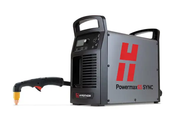

Powermax65 SYNC plasma cutter
The Powermax65 SYNC® is a next-generation professional grade air plasma cutter that dramatically simplifies system operation for gouging and recommended cutting up to 20 mm (3/4″). Featuring automated system process set-up via advanced RFID-enabled SmartSYNC® torches and a revolutionary single-piece cartridge consumable that provides trackable utilization data. The Powermax65 SYNC maximizes productivity through reductions in downtime, optimized cut quality performance and streamlined consumable inventory management.
