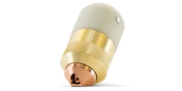

Patented FlushCut™ consumables have been specifically designed to allow Powermax users to cut attachments, lugs, pad eyes and other positive features as close to the base as possible without piercing or damaging the workpiece. An angled nozzle bore design and flat guiding shield enables flush cutting that leaves less than 5 mm (3/16”) residual material on the base or work piece, reducing grinding and secondary repair operations.

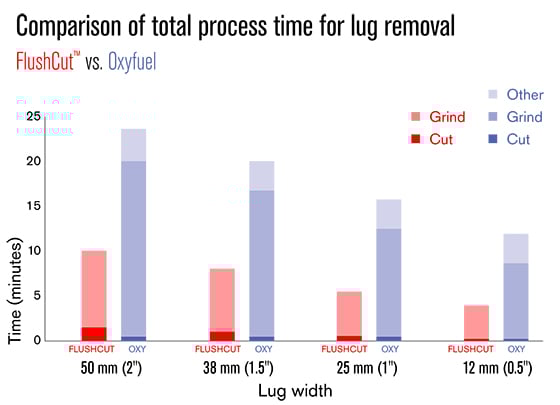

- Heat affected zone (HAZ) associated with flush cutting is approximately ten times less than that of oxyfuel allowing you to cut closer to the base material
- Less overall pre-processing time (e.g. no gas setting, purging or preheating) than oxyfuel
- Remove lugs and attachments in a single pass compared to carbon arc gouging which requires multiple passes and additional time

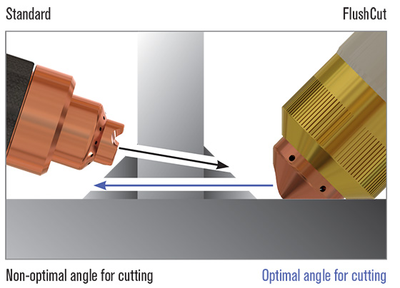

- The angled nozzle bore of FlushCut consumables reduces secondary grinding by leaving minimal residual material
- The 45 degree angle of the FlushCut arc allows for lugs and attachments to be removed with a flat bottom, increasing the chances for the lug or attachment to be reused
- The guiding flat on the shield helps operators avoid digging into the base plate, reducing the need for costly repairs
