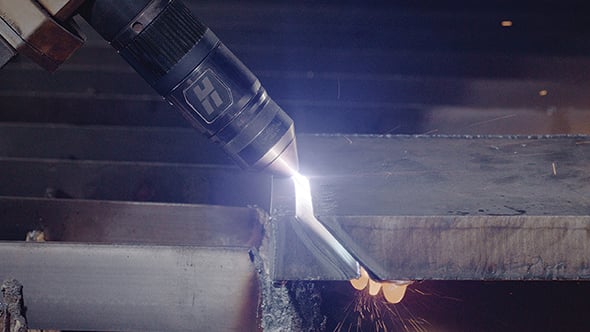

Image of bevel being cut in 51mm thick metal

Plasma beveling
Plasma beveling is a cutting process that creates angled edges on metal parts, typically in preparation for welding. This technique involves using a plasma torch to cut the metal at various angles, resulting in different edge profiles such as V, A, X, Y, and K-type bevels.

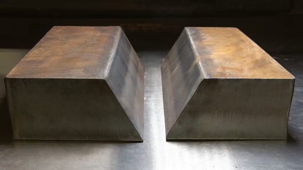

Image of finished bevel cut
Key benefits of plasma beveling include:
High precision and consistency: Modern plasma process solutions, such as Hypertherm® True Bevel™ technology, offer accurate and repeatable cuts.
Efficiency: Plasma beveling can be faster and more cost-effective than traditional methods. Plasma cutting requires less gas consumption than oxyfuel and lower maintenance costs than fiber laser, making it more economical over time.
Reduced need for secondary operations: The high-quality cuts often eliminate the need for additional grinding or finishing.

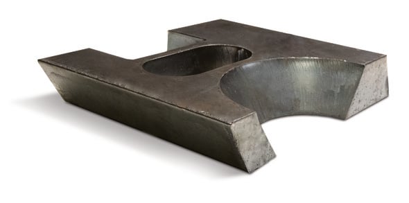

What is off-table beveling?
Off-table beveling refers to beveling metal parts outside a traditional CNC cutting table setup. This method is beneficial when dealing with large or irregularly shaped workpieces that cannot fit on a standard cutting table.
Image of H sample cut with bevels
Key Benefits of Off Table Beveling
  • Flexibility: Allows beveling and cutting in various locations inside the shop and the field.
  • Efficiency: Reduces bottlenecks in production by enabling beveling without needing a dedicated CNC table.
Scrap metal reduction: Off table beveling allows for better plate utilization as you can bevel after well-nested parts are cut.
  • Improved quality: Systems like the DC-IV MAX from Bug-O Systems provide precise, repeatable bevels with minimal setup time.
  • Reduced material handling: Lightweight and portable equipment can be brought directly to the workpiece, minimizing the need for moving heavy materials.

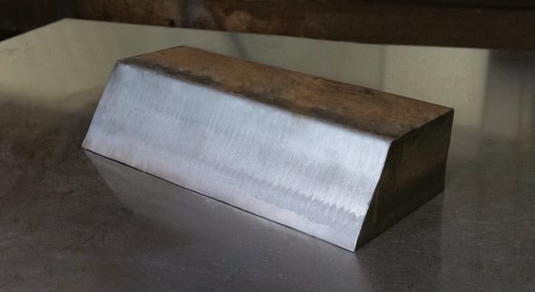

Why is plasma the best technology for metal beveling?
Plasma technology is considered one of the best methods for metal beveling due to several key advantages:
Precision and accuracy: Modern plasma systems, especially those with high-definition capabilities, offer highly precise cuts with minimal taper angles. This precision is crucial for creating accurate bevels that fit perfectly for welding and assembly.
Speed and efficiency: Plasma beveling is significantly faster than traditional methods like oxyfuel cutting. This increased speed translates to higher productivity and reduced lead times.
Versatility: Plasma technology can cut through various electrically conductive materials, including stainless steel, aluminum, and mild steel. It can also create bevel shapes such as V, Y, X, and K.
Quality of cuts: The cuts produced by plasma beveling are clean and smooth, often eliminating the need for secondary finishing processes. This high-quality edge is essential for ensuring strong welds and reducing preparation time.
Automation and integration: Modern plasma beveling systems can be integrated with CNC machines, allowing for automated and highly repeatable cuts. This integration enhances consistency and reduces the need for manual intervention.
Image of single bevel on 51mm metal

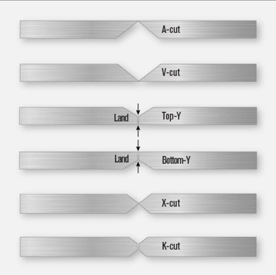

What are the five types of plasma bevel cuts?
The five types of plasma bevel cuts are A, K, V, X, and Y. Each type has unique characteristics and applications:
A bevel: This is the most common type of bevel cut. It requires a single torch pass and leaves a cut edge that protrudes on top. It's often used for simple welding preparations.
K bevel: The most complex profile requires three passes of the torch. It combines a top Y and a bottom Y, leaving a vertical land in the middle of the cut. This type is used for creating strong, multi-pass welds.
V bevel: A V bevel is essentially an inverted A bevel, requiring one torch pass. The cut protrudes on the bottom edge. It's used for welding joints that need full penetration.
X bevel: A combination of A and V bevels, where the mid-point of the two cuts meets in the middle of the plate, forming an X shape. This cut requires two torch passes. It's used for creating joints that need balanced strength on both sides.
Y bevel: Comes in two varieties ― top Y and bottom Y. The top Y has a V bevel that doesn't extend through the plate, leaving a vertical face at the bottom. The bottom Y is the opposite, with the vertical face at the top and an A bevel at the bottom. These cuts are used for specific welding applications where partial penetration is required.
Image of types of bevel cuts
