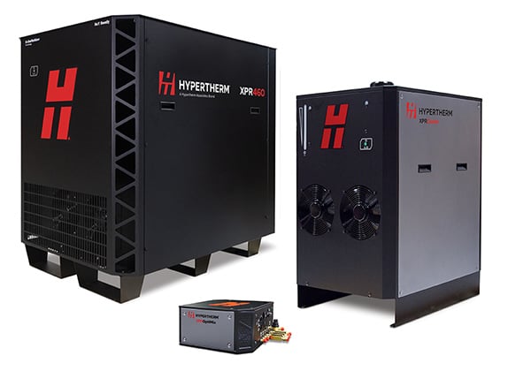

XPR460 plasma cutting system
The Hypertherm XPR460® is part of the world’s most powerful and versatile family of mechanized plasma cutters for cutting mild steel, stainless steel, and aluminum over various thicknesses and imperfect surfaces. XPR460 pays you back with maximum versatility, productivity, and precision. You can expect superior part-to-part consistency over consumable life from the first cut to the last. XPR460’s precision cutting produces parts with less dross and rework, reducing secondary operations.
System information
Benefits
Widest versatility expands capabilities
Provides superior cutting versatility for mild steel, stainless steel, and aluminum
Offers the widest range of cutting power for various metals and thicknesses
Delivers high-quality, consistent cutting on imperfect metal surfaces, including paint and rust
- XPR automated gouging minimizes or eliminates grinding compared to carbon arc gouging, producing weld-ready parts faster with cleaner gouge profiles
Optimized productivity drives lower operating costs
Maximum power optimizes productivity by delivering higher cut quality, thicker cutting capability, and faster cutting speeds
Argon-assist technology enables piercing and edge-starting on the thickest mild steel and stainless steel
Cuts with oxygen up to 460 Amps, delivering the best cutting outcomes on mild steel
Exclusive Arc Response Technology™ intervenes in adverse events to preserve consumable life and prevent torch damage
Extended Pilot Arc (EPA) eliminates manual edge‑finding, streamlining setup and minimizing downtime for improved operational efficiency.
The web interface tool can be accessed via Wi-Fi and Ethernet LAN in the power supply for system monitoring and service
Built-in IIoT (Industrial Internet of Things) via Ethernet LAN and MTConnect® enables remote data access for smarter monitoring from anywhere in the world
Manual Set-Mode is ideal for straightforward applications like gouging and off-table beveling; it retains your last setup for faster, repeatable workflows and simplifies set up and operations without the need for CNC/PLC integration
Delivers excellent part-to-part consistency over consumable life from the first cut to the last
Provides a smooth surface, low angularity, and minimal to no dross for clean parts off the table
XPR® embedded technology improves 45-degree bevel cut quality on thick material making the welding process more efficient
Exclusive SureCut™ technology delivers improved outcomes by automatically embedding advanced cutting capabilities into our plasma cutting process

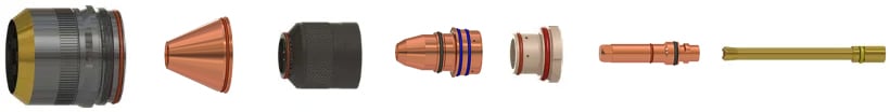

XPR consumables
Mild steel
| Amperage | Process | Shield cap | Shield | Nozzle retaining cap | Nozzle | Swirl ring | Electrode | Water tube |
| 220 A | O2/Air | 420200 | 420273 | 420365 | 420270 | 420406 | 420276 | 420368 |
| 300 A | O2/Air | 420200 | 420491 | 420365 | 420279 | 420406 | 420276 | 420368 |
| 460 A | O2/Air | 420200 | 520002 | 420365 | 520001 | 420819 | 420834 | 420368 |
Non-ferrous
| 130 A | N2/N2 | 420200 |
420318 |
420365 |
420315 |
420314 | 420356 | 420368 |
420356 |
420368 |
| Air/Air | 420200 | 420513 | 420365 | 420524 | 420260 | 420258 | 420368 | |
| H2-Ar-N2/N2 | 420200 | 420362 | 420365 | 420359 | 420358 | 420356 | 420368 | |
| N2/H2O | 420200 | 420475 | 420365 | 420359 | 420323 | 420356 | 420368 | |
| 460 A | H2-Ar-N2/N2 | 420200 | 420998 | 420365 | 420996 | 420358 | 420997 | 420368 |
Gouging Consumables
Mild Steel
Nozzle* | Swirl ring | Electrode | Water tube |
| 170A | O2/Air | 420200 | 10086659 | 420365 | 10087904 (.140) Bore |
420242 | 10086653 | 420368 |
| 300A | O2/Air | 420200 | 10086659 | 420365 | 10086655 (.180) Bore |
| 460A | O2/Air | 420200 | 10086659 | 420365 | 10086657 (.195) Bore |
*Reference "XPR Gouging Charts for Nozzle"
Stainless Steel
| 170A | H2-Ar/N2 | 420200 | 10086659 | 420365 | 10087907 (.165) Bore |
420242 | 10086650 | 420368 |
| N2/N2 | 420200 | 10086659 | 420365 | 10087907 (.165) Bore |
| 300A |
H2-Ar/N2 | 420200 | 10086659 | 420365 | 10087909 (.210) Bore |
| N2/N2 | 420200 | 10086659 | 420365 | 10086655 (.180) Bore |
| 460A |
H2-Ar/N2 | 420200 | 10086659 | 420365 | 10087911 (.250) Bore |
| N2/N2 | 420200 | 10086659 | 420365 | 10087909 (.210) Bore |
