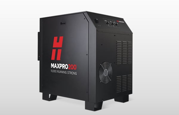

MAXPRO200 plasma cutter
MAXPRO200 does the work, so you can too

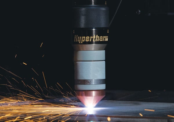

Dubbed the industry workhorse because of its power and 100% duty cycle, the MAXPRO200® plasma cutter is designed for your heavy-duty, high-capacity automated and handheld cutting and gouging applications.

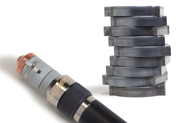

Now available with new MAXPRO200 FlushCut™ consumables, engineered for faster, safer attachment removal with minimal grinding and zero-base material damage.
The powerhouse plasma cutter delivers:

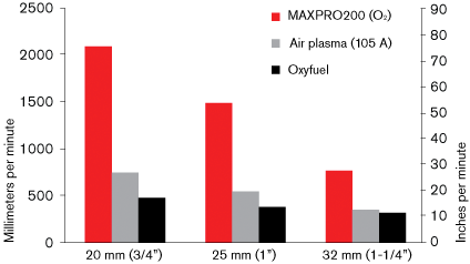

The fastest cutting speeds and most extended consumable life in its class to produce more parts at a lower cost;
Versatile cutting thicknesses to expand work applications;
Multiple plasma processes that enable consistent cut quality with less rework;
And a straightforward system that’s easy to install, easy to operate, and easy to maximize performance.
MAXPRO200. Get work done.

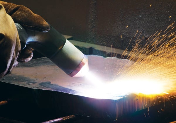

Drag Cutting

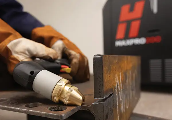

Flush Cutting
For cutting closer to base materials using a 22.5° angle

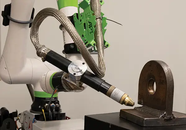

Mechanized Cutting
Robotic Cutting
For cutting various shapes and improving productivity

Fastest cut speeds in its class produce more finished parts per hour

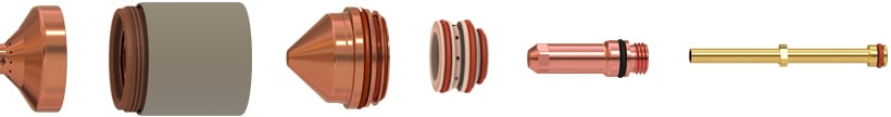

MAXPRO200 offers a wide range of torch and consumable options to support different cutting processes, applications, and operating environments—giving you the flexibility to configure the system that best fits your needs. Please contact an authorized Hypertherm partner to place your consumables order. Consumables shown may vary in appearance.

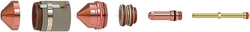

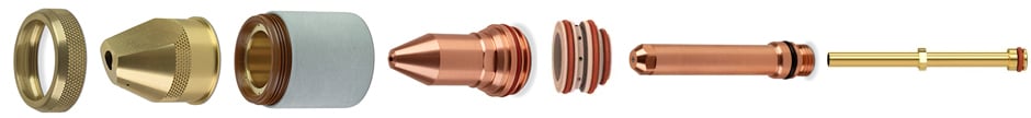

MAXPRO200 machine torch consumables
Air – Mild steel / Stainless steel / Aluminum
Shield Shield cap Nozzle Swirl ring Electrode Water tube
200 amp - Air consumables - Mild steel / Stainless steel / Aluminum
| Amperage | Shield | Shield cap | Nozzle | Swirl ring | Electrode | Water tube |
| 50 A | 220532 | 220936 | 220890 | 220529 | 220528 | 220521 |
| 220935 without tab | ||||||
| 130 A | 220536 | 220936 | 220892 | 220488 | 220487 | 220521 |
| 200 A | 420045 | 220936 | 420044 | 220488 | 220937 | 220521 |
O2 – Mild steel
200 amp - O2 consumables - Mild steel
| 50 A | 220532 | 220936 | 220891 | 220529 | 220528 | 220521 |
| 130 A | 220491 | 220936 | 220893 | 220488 | 220487 | 220521 |
| 200 A | 220832 | 220936 | 220831 | 220834 | 220937 | 220521 |
N2 – Stainless steel / Aluminum
200 amp - N2 consumables - Stainless steel / Aluminum
| 130 A | 220536 | 220936 | 220892 | 220529 | 020415 | 220521 |
| 200 A | 420045 | 220936 | 420044 | 220529 | 020415 | 220521 |

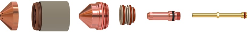

MAXPRO200 hand torch consumables
| 50 A | 420063 | 220935 | 220890 | 220529 | 220528 | 220521 |
| 130 A | 420061 | 220935 | 220892 | 220488 | 220487 | 220521 |
| 200 A | 420058 | 220935 | 420044 | 220488 | 220937 | 220521 |
| 200 A gouging | 420067 | 220935 | 420066 | 220488 | 220937 | 220521 |
O2 – Mild steel
| 50 A | 420063 | 220935 | 220891 | 220529 | 220528 | 220521 |
| 130 A | 420062 | 220935 | 220893 | 220488 | 220487 | 220521 |
| 200 A | 420059 | 220935 | 220831 | 220834 | 220937 | 220521 |

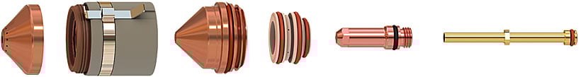

MAXPRO200 extreme bevel consumables
Air – Mild steel
| 130 A | 420735 | 220936 | 420829 | 220488 | 420824 | 420823 |
| 200 A | 420737 | 220936 | 420734 | 220488 | 420732 | 420823 |
O2 – Mild steel
| 130 A | 420735 | 220936 | 420828 | 220529 | 420824 | 420823 |
| 200 A | 420737 | 220936 | 420733 | 220488 | 420732 | 420823 |
MAXPRO200 FlushCut consumables
Air/Air – Mild steel
Retaining RingShieldRetaining CapNozzle Swirl ring Electrode Water tube
| Amperage | RETAINING RING | Shield | RETAINING cap | Nozzle | Swirl ring | Electrode | Water tube |
| 200 A | 10087802 | 10087213 | 420793 | 10087212 | 220488 | 420732 | 420823 |

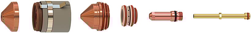

MAXPRO200 gouging consumables
Air – Mild steel
| 200 A | 420885 | 420794 | 420886 | 420928 | 420887 | 420881 |
| 420793 without tab |
O2 – Mild steel
| 200 A | 420885 | 420794 | 420886 | 420883 | 420887 | 420881 |
AIR – Stainless steel /Aluminum

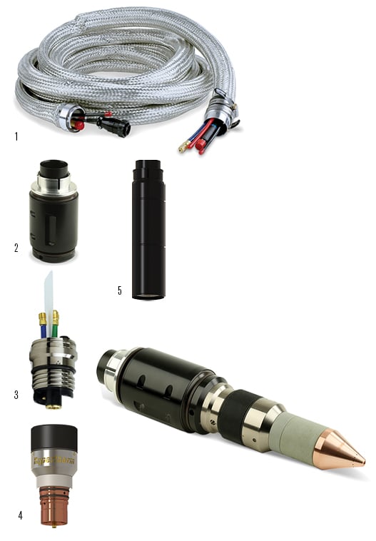

Robotic torch assembly options
Robotic lead
| Part number | Description | length | |
| 1 | 429107 | Robotic Lead 7.5 m (25′) (compatible with Robotic torch receptacle 420945) | 7.5 m (25′) |
Robotic torch
| 3 | 420945 | Robotic Torch Receptacle (compatible with XPR mounting sleeves) | |
| 4 | 220921 | Quick-disconnect torch |
Robotic torch mounting sleeces options
| 5 | 420501 | Mounting Sleeve: Short |
155 mm (4.4″) 5.72 cm (2.25″) |
| 420500 | Mounting Sleeve: Medium (Standard) |
233 mm (9.2″) 5.72 cm (2.25″) |
| 420502 | Mounting Sleeve: Extended |
311 mm (12.3″) 5.72 cm (2.25″) |
| 2 | 420788 | Rotational Sleeve: Short |
154 mm (6″) 76 mm (3″) |
| 420789 | Rotational Sleeve: Medium |
233 mm (9.2″) 76 mm (3″) |
| 420790 | Rotational Sleeve: Extended |
311 mm (12.3″) 76 mm (3″) |
