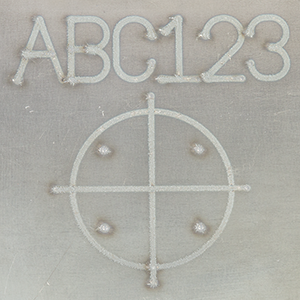

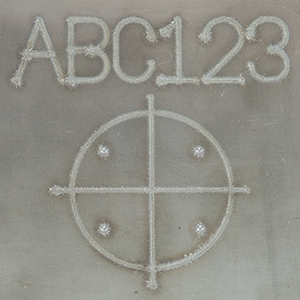

Light score and heavy score mark profiles
There are primarily two different types of mark profiles: light score and heavy score. Usually, the choice depends on whether the mark will be seen on the final product. If the mark needs to be visible after painting, for example, a heavy score is preferable. For temporary part identifiers that won’t be needed after final assembly, a light score is probably a better choice, as it can be easily removed with a grinder or covered with a layer of paint.
A number of parameters of the Powermax45 XP system can be easily adjusted to achieve different mark depths, widths, and appearances on various types of metal.
  • A low output current of 10 amps will produce a light score.
  • A higher output current of 15 to 25 amps will provide a heavier score.
  • Slower torch motion speeds combined with a low torch-to-work distance will increase the width and depth of the mark.
  • Faster torch motion speeds with a higher torch-to-work distance will decrease the width and depth of the mark.
Metal marking using light air Metal marking using heavy air
