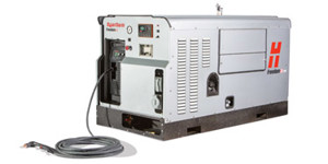

Freedom 38 PPA engine-drive plasma system
