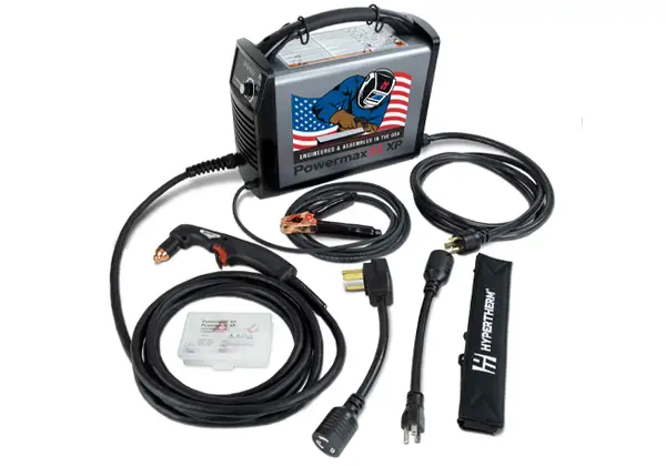

Below are the standard system configurations, which include a power supply, torch, and work lead.
Duramax LT hand torch with 4,5 m (15′) lead and work clamp with 4,5 m (15′) lead
Powermax33 XP power supplies
Handheld
120-240 V CSA USA Edition
088592
120-240 V CSA International handheld
088590
#088590 and #088592 include:
  • Power supply, 4,5 m (15') Duramax LT hand torch with standard consumables, 4,5 m (15') work clamp
  • 240 V/20 A plug with adapters for 120 V/15 A and 240 V/20 A circuits (CSA models)
  • Operator and safety manuals
  • Consumable kit with 1 standard nozzle, 1 electrode, 1 FineCut® nozzle and 1 FineCut deflector
  • Carrying strap
