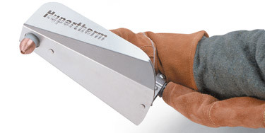

Duramax retrofit torches for Powermax600/800/900 and MAX42/43 systems
Duramax™ retrofit torches can give older Powermax system new life with enhanced performance and productivity. Available for Powermax600/800/900 and MAX42/43 systems, –retrofit torches use the torch connection designed for your system, so installation is simple; both handheld and mechanized styles are available with or without quick disconnect.
- Handheld and machine styles available
- Proprietary, fiber-reinforced torch handle is 5 times more impact resistant and 20% more heat resistant than T-style torches
- SpringStart™ electrode technology eliminates moving parts in the torch for more reliable arc-starting

HyAccess consumables
For more information on HyAccess consumables, visit the HyAccess product page.
| Retaining cap | Nozzle | Electrode | Swirl ring |
| Consumable type | Torch type | Amperage | Retaining cap | Nozzle, cutting | Nozzle, gouging | Electrode | Swirl ring |
| HyAccess™ | Hand | 15-65 | 420413 | 420410 | 420412 | 420408 | 220857 |
