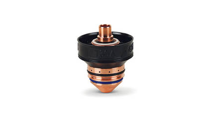

Our Complete Family of HPR Cartridges, From 80 A to 400 A, Simplifies Mechanized Cutting
Eliminates downtime and increases productivity
Reduces consumable parts by 80%, giving operators more time cutting and less time changing consumables.
Eliminates consumable stack-up mistakes that can lead to costly rework, plate damage, and torch or consumable failures.
Simplifies operator training with one cartridge instead of five standard consumables.
Increases productivity for thick metal cutting and beveling applications with the new 400-amp cartridge.
Enhances cut quality
Provides consistent cut quality throughout consumable life compared to standard HPR consumables.
Ensures peak cut quality with factory-assembled, precision-aligned consumables in every cartridge.
Helps ensure operation at recommended amperages with fewer consumable parts to manage.
Simplifies consumable management
Simplifies inventory and ordering with one consumable per process.

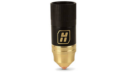

Delivers a toolless consumable change without removing the torch.
Enables fast, foolproof installation with a clearly marked single-piece consumable.
Enables faster process changes and upgrades with a simplified consumable platform.
Reduces scrap, rework, and operating costs
Protects costly thick plates from damage with error-proof consumable replacement.
Reduces costly rework and scrap caused by consumable errors.
Eases secondary operations, including grinding.
Decreases consumable costs associated with purchasing, inventory, and storage.

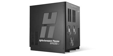

Provides plug-and-play compatibility with existing HPRXD systems
Installs easily on standard HPRXD systems with direct receptacle compatibility.
Requires no setting changes, eliminating additional setup requirements.
Maximizes equipment investment by letting you use your existing HPRXD torch across all HPR processes.
HPR cartridge part numbers
HPR cartridge
HPR cartridge consumablesNew!
| Mild steel process | Retaining cap | Cartridge (10 pk) | Water tube | Torch body |
| 80 A (standard cutting / bevel cutting)* | 420708 | 420803 | 420728 | 420729 |
| 130 A (standard cutting / bevel cutting)* | 420708 | 420705 | 420728 | 420729 |
| 260 A (standard cutting / bevel cutting)* | 420708 | 420715 | 420728 | 420729 |
| 400 A (standard cutting / bevel cutting)* | 420708 | 420727 | 420728 | 420729 |

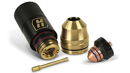

HPR cartridge kitsNew!
| Type | Kit p/n | Includes p/n | Description | Quantity |
| Torch starter kit | 528101 | 420729 | Torch body | 1 |
| 420728 | Water tube | 1 | ||
| 420708 | Retaining cap | 1 | ||
| 528107 | Kit: O-ring cartridge torch | 1 | ||
| Cartridge 3-pk kits |
| 528103 |
420705 |
Kit: Cartridge, 130 A | 3 | |
| 528104 | 420715 | Kit: Cartridge, 260 A | 3 | |
| 528105 | 420803, 420705, 420715 | Kit: Cartridge, multi-amps kit contains (1) of each amperage (80 A, 130 A, and 260 A) | 3 | |
| 528165 | 420727 | Kit: Cartridge, 400 A | 3 | |
| 528166 | 420705, 420715, 420727 | Kit: HPRXD Cartridge, high-amps kit contains (1) of each amperage (130 A, 260 A, and 400 A) | 3 |
