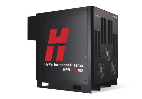

HyPerformance HPR400XD
The HyPerformance® HPR400XD® plasma system has been designed and built for maximum performance and productivity in X-Y, bevel, and robotic cutting operations. The versatile 400-amp-rated system combines fast cutting speeds, rapid process cycling, quick changeovers, and high reliability, delivering the ultimate in HyPerformance mild steel cutting, plus aluminum capability and unmatched stainless steel cut quality.

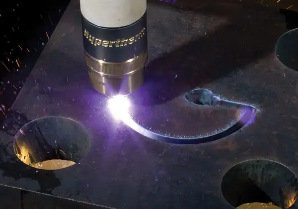

Superior cut quality and consistency
  • HyPerformance plasma cuts fine-feature parts with superior quality and consistency
  • HyDefinition® technology aligns and focuses the plasma arc for more powerful precision cutting up to 80 mm (3.2″)
  • New HDi™ technology delivers HyDefinition cut quality on thin stainless steel, with extremely sharp top edge quality, shiny surface finish, and superior angularity with reduced angle variation

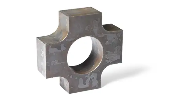

  • Patented True Hole™ technology (auto gas systems only) produces hole quality that is significantly better than anything previously achievable with plasma
Minimized operating cost
  • LongLife® technology significantly increases consumable life and enables consistent HyDefinition cut quality
  • Faster cut speeds let you produce more parts per hour; higher quality cutting virtually eliminates the cost of secondary operations
  • Patented PowerPierce® technology lets you pierce  thicker than ever before and replace slower-cutting oxyfuel technology

Specifications
General
Maximum OCV (U0) 360 VDC
Maximum output current (I2) 400 Amps
Output voltage (U2) 50 – 200 VDC
Duty cycle rating (X) 100% @ 80 kw, 40° C (104° F)
Ambient temperature/Duty cycle Power supplies will operate between -10° C and +40° C (+14° and 104° F)
Power factor (cosφ) 0.98 @ 400 ADC output
Cooling Forced air (Class F)
Insulation Class H
Mild steel cut capacity Dross free
Production pierce
Maximum cutting capacity
38 mm (1-1/2")
50 mm (2")
80 mm (3.2")
