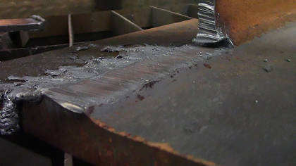

Choosing the Hypertherm® FlushCut process provides a faster, cleaner, and more precise alternative to traditional methods like oxyfuel and carbon arc gouging. Unlike oxyfuel, which struggles with non-ferrous metals and leaves hard to remove slag, plasma delivers smooth, consistent cuts across a wide range of materials and has up to 10 times less heat affected zone (HAZ). Compared to carbon arc, plasma flush cutting produces minimal slag and debris, reducing the need for grinding. With the ability to cut closer to the base metal, and then plasma washing the residual metal away, FlushCut reduces the need for time consuming and labor-intensive grinding thus helping fabricators to improve productivity and cut costs.

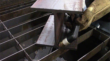

  • Welding access hole (“rat hole”) cuts in I and H beams — provides welders with necessary access to beam flanges for full penetration welds, improving structural integrity and compliance with engineering standards

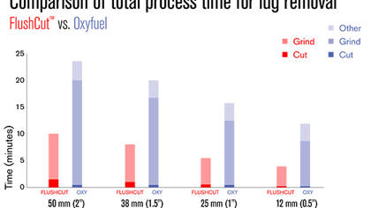

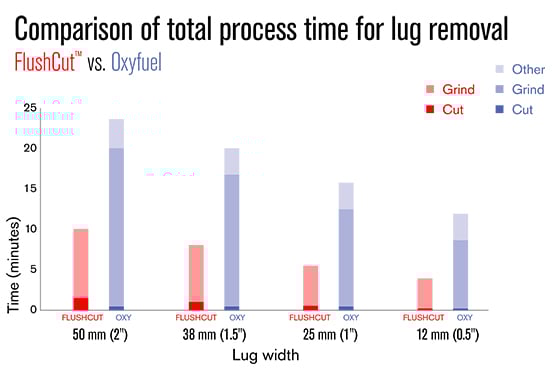

image of time comparison chart

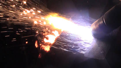

Image of flush cutting a coupon
  1. Faster cutting speeds
    Cuts significantly faster than oxyfuel or carbon arc, especially on thinner materials and non-ferrous metals.
  2. Versatile material compatibility
    Works effectively on a wide range of metals, including stainless steel and aluminum — unlike oxyfuel, which is limited to ferrous metals.
  3. Cleaner edge quality
    Produces smooth, consistent edges with minimal slag or dross — reducing grinding or secondary finishing.

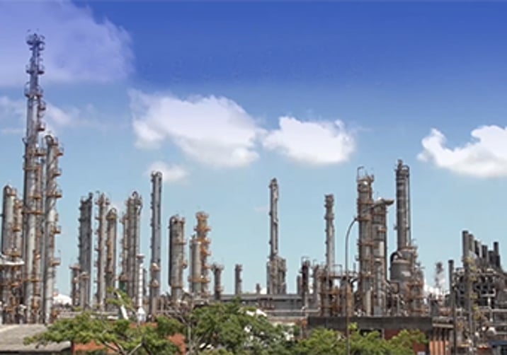

Petrochemical plant
Petrochemical plant
In the past, whenever this Brazilian petrochemical plant had to remove corroded pipes from its reactors, a full 15-day factory shut-down was required. Today, with Powermax® plasma and FlushCut™ consumables it is possible to do the job without disrupting production.

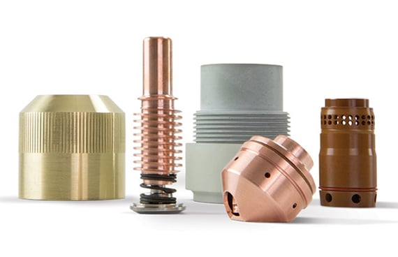

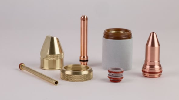

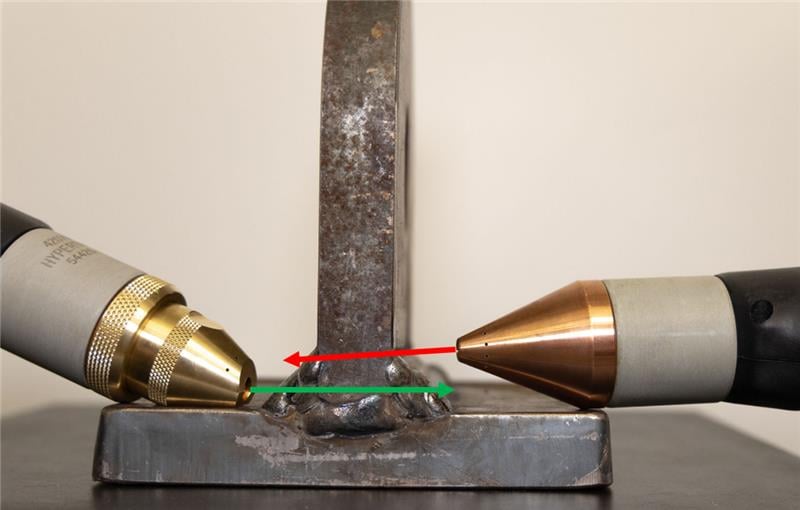

Patented FlushCut consumables

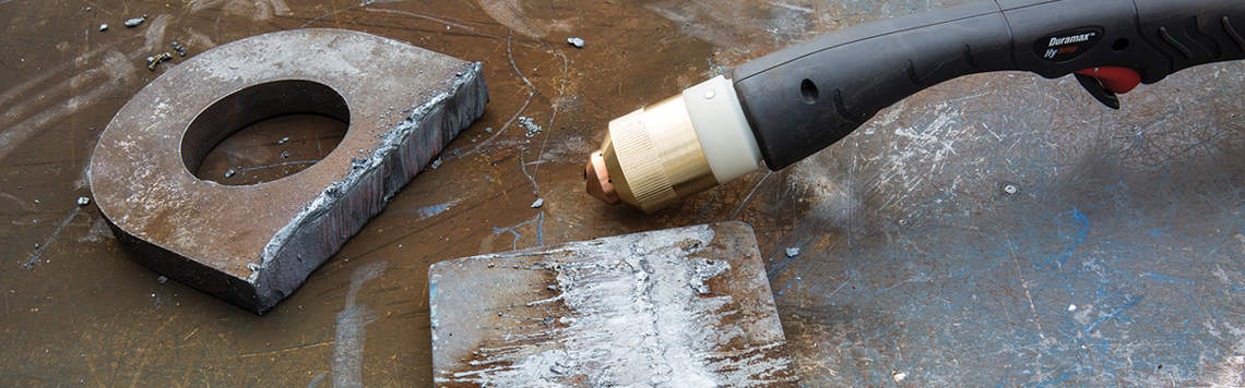

Patented FlushCut™ consumables and cartridges for Powermax systems have a non-centric nozzle bore design that allows the plasma arc to come out of the torch at a 45-degree angle, allowing for lugs and attachments to be removed with a flat bottom, increasing the chances for the lug or attachment to be reused. The angled nozzle bore design and flat guiding shield enable flush cutting that leaves less than 5 mm (3/16 in) residual material on the base or workpiece, reducing grinding and secondary repair operations.
Flush Cut consumables and cartridge image
Powermax FlushCut consumables
