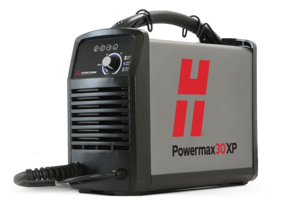

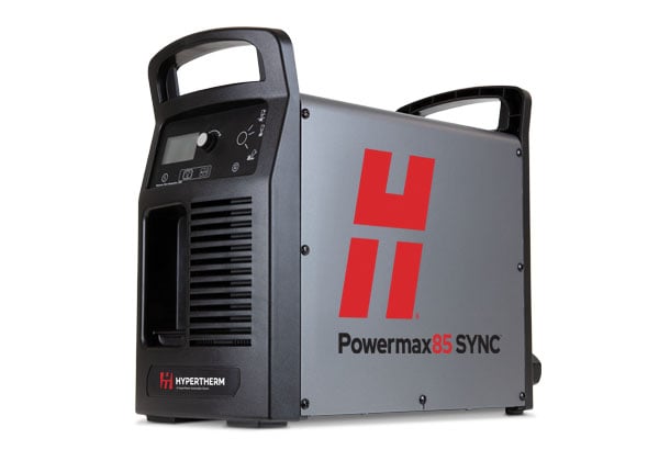

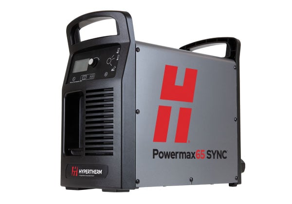

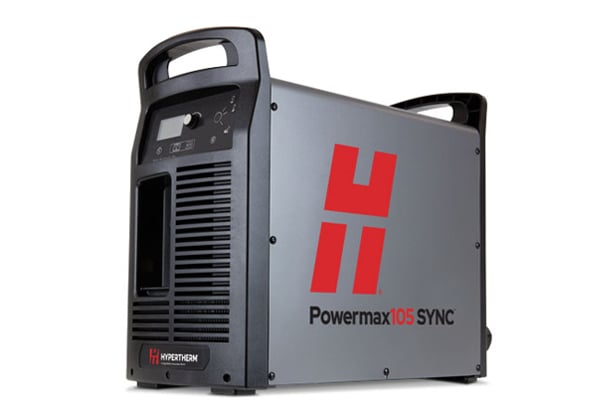

Output amperage range 15–30 A 15–33 A 10–45 A 20–65 A 25–85 A 30–105 A 30–125 A
Recommended cut capacity   8 mm (5/16″) 13 mm (1/2″) 16 mm (5/8″) 20 mm (3/4″) 25 mm (1″) 32 mm (1-1/4″) 38 mm (1-1/2″)
Severance cut capacity   16 mm (5/8″) 20 mm (3/4″) 29 mm (1-1/8″) 32 mm (1-1/4″) 38 mm (1-1/2″) 50 mm (2″) 57 mm (2-1/4″)
Mechanized pierce capacity 12 mm (1/2″) 16 mm (5/8″) 20 mm (3/4″) 22 mm (7/8″) 25 mm (1″)
ISO 9013 cut range 5 5 5 5 5 5 5
