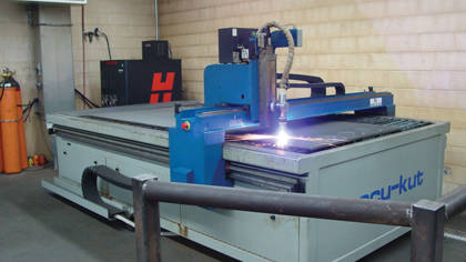

T & J Manufacturing is a second-generation full-service welding, machining, and fabrication shop specializing in burial vault lowering devices, thin gauge hydraulic tanks, shroud work, and fenders. Founded in 1982, T & J has nine employees in the shop and four in the office. All plasma cutting and production is completed in one shift. Driven by regular customers with weekly orders that dictate the production cycle, the company advanced from oxyfuel cutting to plasma cutting a few years ago.

After learning about True Hole technology for mild steel during a visit to the Hypertherm booth at the FabTech trade show, T & J asked their table manufacturer what investment the XD upgrade and True Hole® technology would require (in terms of time, money, and training) and how the upgrade would benefit their cutting process and finished products. Most importantly, they wanted to understand how True Hole technology could improve the quality of their plasma cut holes.
It took a few months to make the decision to invest in the technology upgrade. To upgrade, T & J had to purchase and install the XD upgrade kit – with a new torch and leads – and update their software to ProNest®. Working with their table manufacturer, they determined that installing the upgrade would be most cost-effective if performed during a previously scheduled preventative maintenance visit.
Gilmore noted, “The upgrade looked like something we could do ourselves, but it made sense to us to have our OEM do it during their yearly PM visit so they could check everything on the table and then train us on the changes.”

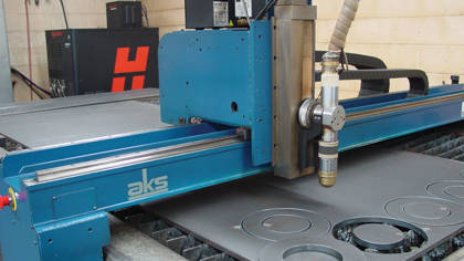

Business impact: Significant improvement in bolt hole quality helps business grow
The first benefit T & J realized from their investment was a significant improvement in bolt hole quality.
“There is a subtle change visually, for those who notice differences in the holes. For example, ½-inch holes in ¼-inch mild steel don’t look a lot different, but a bolt fits in them nicely and True Hole makes it automatic. I used to have to program bigger holes; .520 for ½ inch, but ProNest takes the guesswork out of it.”
Jeremy Gilmore
Production Manager, T & J Manufacturing
In addition to the bolt-ready holes, Gilmore has also seen an improvement in slots. “It wasn’t something we were expecting when we chose to upgrade, but the better slots have led us to other uses, like cutting 3-inch-tall letters in ¼ inch plate, something new for us and it did a nice job.”
The new True Hole capability has increased business with customers drawn to the quality, and Gilmore anticipates that the technology upgrade, including ProNest, will pay for itself in as little as three or four months. “True Hole improves the look and quality of our products, and ProNest makes it easy.”
