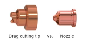

Plasma cutter drag tips or drag shields do nothing more than allow you to drag your torch on the metal that you are cutting. For this to happen, this drag tip must be electrically isolated from the torch circuitry.
What is a plasma cutter drag tip?
Example of a drag cutting tip or drag cutting shieldA drag tip is basically a copper shield that attaches to the front of the torch ahead of the nozzle. This shield electrically isolates the nozzle from the metal work piece to eliminate a common phenomenon known as double arcing so you can drag your torch directly on the workpiece without it sticking.
There are a couple of advantages to drag cutting. The first is, it makes things easier for the operator. You don't have to worry about having a steady hand. You can simply drag the torch along a straight edge or template. In most cases, you should wind up with a more accurately cut piece. Drag cutting also helps to increase consumable life as metal spatter and blow back isn't as much of a problem. Hypertherm offers shielded cutting technology up to 200 amps with a hand torch.

What is the difference between a drag tip and a nozzle?
The major difference between the nozzle and a drag tip is that the nozzle is sometimes a part of the electrical circuit while the drag tip never is. When the nozzle is part of the circuit it is the ground that the arc wants to attach to. After the arc has been established and transferred to the metal, the purpose of the nozzle is to shape and focus the arc. Both pieces are plasma cutter consumables, but it’s important to note that they are not the same thing.

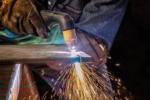

What is drag cutting?
Drag cutting is a plasma cutting process that uses drag tips to shape metal. This method is mainly used for thin metals, like sheets, and provides more control than other methods like stand-off cuts. In addition, the process results in a smooth edge that is free from burrs and other inconsistencies.
Drag cutting with plasma works by having the tip of your cutter touching the material you're working on, then moving it slowly across its surface while maintaining a constant speed and height. This will create an even, straight cut. You can drag the torch along in a straight line or make curvy patterns.
Although drag cuts require patience and practice since you're drawing out each line while cutting through the material with speed and precision, many people find drag cutting easier than holding a stand-off.
Common mistakes when using a drag tip
Drag cutting using a plasma cutter drag tip is fairly easy to learn. The most common mistake new operators make when learning to drag cut is moving the torch too quickly so that the plasma arc doesn’t have enough time to actually cut through the workpiece. A quality cut has lines on the cut face that angle slightly back from the travel direction at around 15-30 degrees, revealing a lot about correct and incorrect speeds. These lines are called lag lines. Be patient while learning how to use this type of plasma cutter tip, especially when dealing with thicker metals. And always make sure to care for your consumables.
