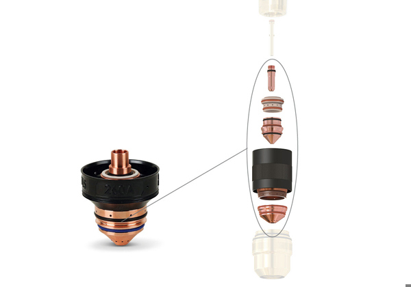

Simplify your cutting process with HPR cartridgeNew!
The Hypertherm HPR® cartridge represents a revolutionary change to traditional mechanized plasma consumables. Dramatically simplifying plasma cutting, the cartridge replaces five standard consumables, eliminating costly stack-up errors. Increase productivity with faster consumable changeover and reduced training time.
HPR cartridges are available for your highest volume cutting processes.

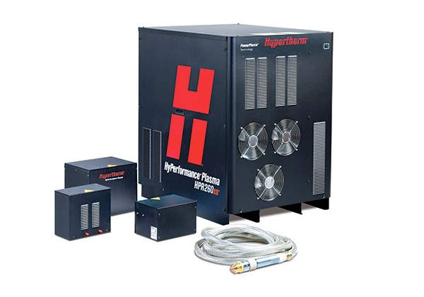

Option #1 (HPR260 and HPR130 systems)
This upgrade is available for HPR260 and HPR130 systems, and includes the following enhancements:
Option #2 (HPR260 and HPR130 systems)
This upgrade for HPR260 and HPR130 systems includes all of the system enhancements of Option #1, plus:

Hypertherm’s XD technology upgrade kit includes a new XD control board, push-connect gas fittings, leads, upgraded torch and consumable technologies, and a visit from a trained technician.
