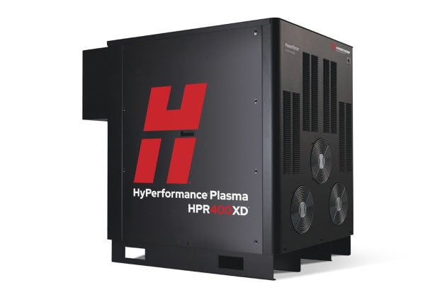

The HyPerformance® HPR400XD® plasma system has been designed and built for maximum performance and productivity in X-Y, bevel, and robotic cutting operations. The versatile 400-amp rated system combines fast cutting speeds, rapid process cycling, quick changeovers and high reliability, and delivers the ultimate in HyPerformance mild steel cutting, plus aluminum capability and unmatched stainless steel cut quality.

General | |
Maximum OCV (U0) | 360 VDC |
Maximum output current (I2) | 400 Amps |
Output voltage (U2) | 50 – 200 VDC |
Duty cycle rating (X) | 100% @ 80 kw, 40° C (104° F) |
Ambient temperature/Duty cycle | Power supplies will operate between -10° C and +40° C (+14° and 104° F) |
Power factor (cosφ) | 0.98 @ 400 ADC output |
Cooling | Forced air (Class F) |
Insulation | Class H |
