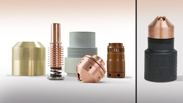

FlushCut consumables
Patented FlushCut™ consumables for Powermax systems have a non-centric nozzle bore design that allows the plasma arc to come out of the torch at a 45 degree angle. This new, patented design lets Powermax users cut closer to base materials. And because of the FlushCut consumables' unique ability to cut so close to base materials, users are more likely to be able to reuse pad eyes, attachments and temporary weld supports.
