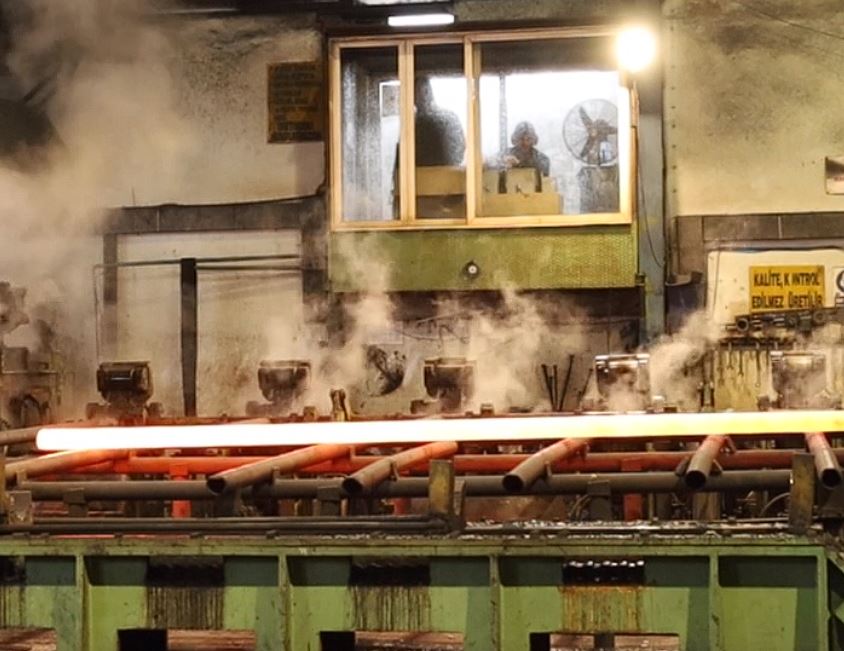

Their main challenge in material cutting is reliability, because the facility runs continuously 24 hours per day, seven days per week. The new system had to minimize downtime to avoid extra costs.
The new solution also had to be versatile, because the material thickness of the products SardoÄŸan cuts varies between four and 30 millimeters. For 13 years, SardoÄŸan relied on the Hypertherm MAX200 plasma cutter, a system that earned their trust by consistently meeting their cutting needs. The new system had to be reliable on all thicknesses and deliver the precise and clean cutting that the MAX200 provided.
