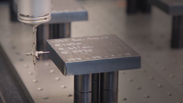

The cut quality from Powermax plasma systems is evaluated using state-of-the-art measurement equipment such as coordinate measuring machines (CMM) and surface roughness measurement (profilometers), along with statistical tools and ISO standards. Coordinate measuring machines are used to measure the cut quality of the cut surface.

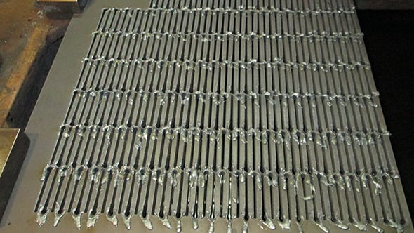

Pierce robustness and rating
Plasma-cutting consumables and cartridges are designed to pierce (cut through) up to a certain thickness. Designing consumables and cartridges that can pierce thick material a few times is straightforward. However, our pierce protocol requires piercing the rated thickness 300 times on a cut table. Our engineers design consumable and cartridge parts and gas flow to support this lofty design specification.
Example piercing test plate
Example of one of the piercing test plates.

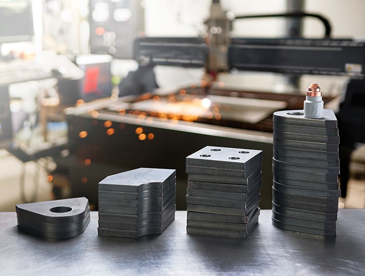

The Powermax SYNC® cartridge consumable platform introduced a single-piece cartridge that delivers industry-leading cutting performance. This is achievable because Hypertherm engineers customized the individual parts of the cartridge (such as electrodes, swirl rings, nozzles, and shields) to meet and exceed the cutting expectations set by users. Each cartridge was meticulously designed by assessing the initial cut quality, quality over life, pierce rating, longer consumable life, and other design requirements.
Every time a user installs a Powermax cartridge, the components are new. Unlike competitive products, Powermax cartridges ensure high-quality cuts from the start and maintain cut quality robustness throughout most of the cartridge life.

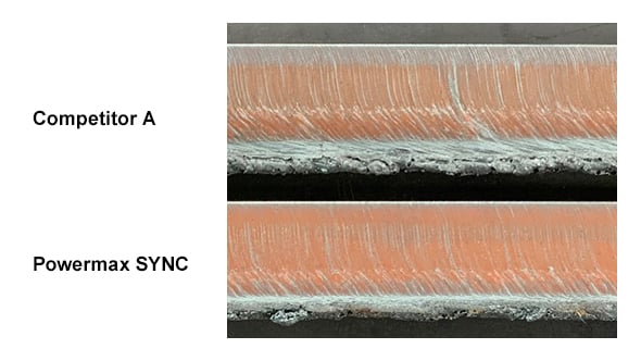

Powermax SYNC vs competitor consumables
Powermax SYNC with a cartridge enables consumable optimization that delivers superior edge features.

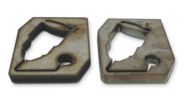

Powermax SYNC cut samples
Stainless steel cut with air (left) and with F5 gas. The 95% nitrogen / 5% hydrogen gas blend gives cuts a silver-color edge, a good angle, and a sharp edge. The blend is recommended for stainless steel only.
