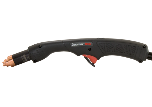

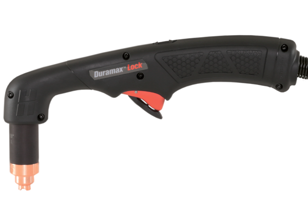

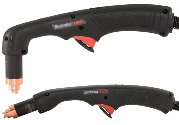

        For hand cutting and gouging jobs
Duramax® Lock 75° and 15° hand torches are well suited for a variety of applications such as gouging, fine feature cutting, extended reach cutting, and flush cutting. The ergonomic design of the 75° torch is perfect for normal cutting, while the 15° torch directs heat away from the operator during heavy gouging and enables cutting overhead or in hard-to-reach areas.

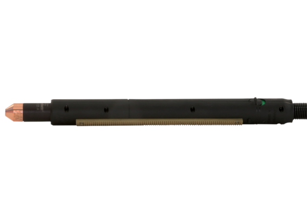

        For machine jobs
Duramax Lock full-length machine torch can be used with a wide variety of CNC cutting tables, track cutters, and pipe-cutters.
