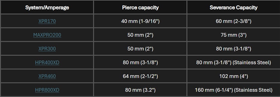

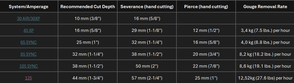

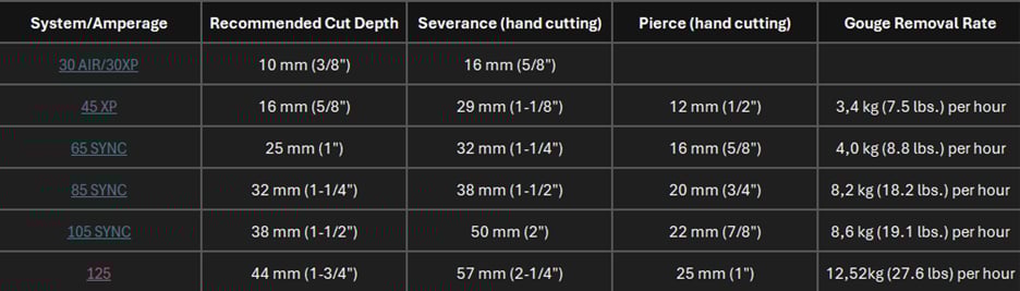

Ideal thickness that plasma cutters can cut to get high quality cuts
The thickness plasma can cut greatly depends on the amperage of the power supply and the torch and consumables. Other significant factors include material type, cutting speed, cutting gases, and part design.
Powermax Systems:
MAXPRO®, HPR®, and XPR® Systems:
