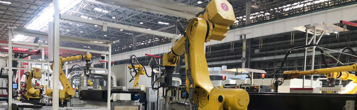

Adding value with robotic plasma beveling
Replacing current hand-held or carriage track beveling processes with robotic automation improves cut quality and consistency, enabling automated welding processes downstream without the need for secondary grinding steps or excessive fill welding by human operators.
When compared to robotic oxyfuel beveling, the efficiency of robotic plasma beveling is more than 3 times higher, with a comprehensive cost 3 to 4 times lower.
The accuracy and reliability of robotic bevel cutting with X-Definition® and air plasma results in superior quality and flexibility, and results in faster lead times, which are critical to remaining competitive in the face of ever-increasing market demand.
