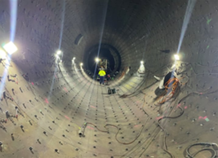

Challenge: Veolia struggled with the operation and fumes of carbon arc gouging
Veolia faced significant challenges with its existing carbon-arc gouging process for removing anchors and cleats. This method required precise cuts for rewelding at the same spot, but the team struggled with the messy operation and excessive fumes generated by carbon-arc gouging. The confined space made the fumes unworkable for operators, and the loud noise posed additional safety concerns.
Image of workers in a tunnel

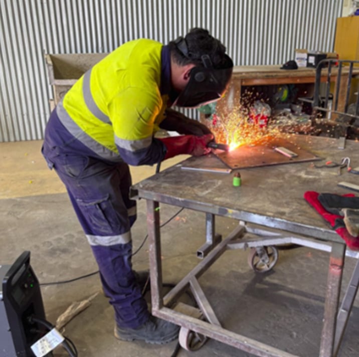

Solution: Plasma flush cutting with Hypertherm Powermax
Mike, an operator at Veolia, discovered Hypertherm® FlushCut™ consumables and reached out to Alphaweld, a Hypertherm premier partner with a strong online presence. Alphaweld arranged two demos: Powermax65 SYNC® and Powermax105 SYNC® with FlushCut consumables. These demos helped the Veolia team understand the differences between Powermax flush cutting and carbon arc gouging.
Image of workers flush cutting

Powermax65 SYNC flush cutting proved ideal for Veolia's needs. The new method was faster, safer, simpler, and easier to set up, saving labor time and enhancing workplace safety.

Close-cutting applications, such as lug and attachment removal, are typically performed with oxyfuel, carbon arc gouging, or traditional plasma cutting tools. Patented FlushCut™ consumables allow Powermax users to cut attachments and other features close to the base without damaging the workpiece.
Using carbon arc gouging to remove welds on both sides of an attachment required multiple passes, consuming extra time and resources. Powermax flush cutting enabled operators to remove attachments in a single cutting pass with significantly less noise and smoke than carbon arc gouging, enhancing overall industrial hygiene and safety.
image of flush cutting up close
