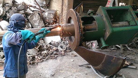

One scrap yard sometimes works with large and unwieldy workpieces that require cutting in places that are difficult to reach.
Challenge: Hand torches expose operators to heat, and require awkward positions to cut
The scrap yard was using several older Powermax1650® plasma systems to cut up scrap. While the cutting process itself was fast and efficient, the standard hand torches operators used with the plasma systems exposed operators to high heat and did not allow operators to access hard-to-reach locations on some workpieces. As a result, operators sometimes had to work from ladders or in an awkward squatting position.
Solution: Powermax125 with Duramax Hyamp Long torch increases speed and safety
Upgrading to the Powermax125® and Duramax® Hyamp™ Long torch allowed operators to complete the same work safer and 50% faster because they could access hard-to-reach locations without climbing, bending over, or squatting.

The Duramax Hyamp Long torch is safer to use in many applications. It’s ergonomic, allowing operators to work in comfortable positions. The length of the torch body and the angle of the cutting head let operators stand upright while still gaining the accessibility they need. Operators avoid back pain caused by bending over, and they can stand beside CNC tables rather than on top of the cutting bed. The long torch also creates more distance, allowing operators to stand further away from the torch’s heat.
Plasma is faster than oxyfuel, and switching to the Duramax Hyamp Long torch lets operators do the same job in a third to a quarter of the time. In fact, existing Duramax Hyamp Long torch customers report skeleton removal from heavy industrial CNC beds is so fast that jobs that previously took an hour can now be finished in under 20 minutes.
Business impact: Hypertherm delivers increased worker speed and safety
The Duramax Hyamp Long torch’s ergonomic design helps operators avoid back pain, improving operator comfort and performance. Operators complete the same work 50% faster because they can access hard-to-reach locations without climbing, bending over, or squatting.
The torch also makes cutting safer by letting the operator stand further away from the cut, minimizing heat exposure and reducing the risk of getting hit by a falling piece of scrap.
