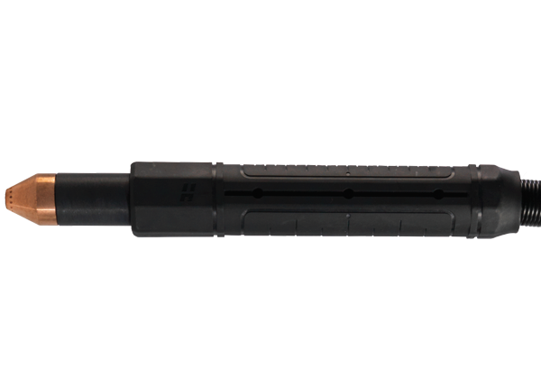

Designed for durability and reliability, Duramax® Hyamp™ torches are built to handle the full 125-amp output of the Powermax125® plasma cutting system and are also compatible for use on lower amp Powermax® systems. Duramax Hyamp torches are available for handheld and machine cutting and gouging, and robotic cutting.
In addition, Duramax Hyamp Long torches are available in .6 m (2′), 1.2 m (4′), and 1.83 m (6′) lengths providing extra reach and durability for heavy-duty applications like scrapping, plate skeleton removal from cutting tables and infrastructure repair or reconstruction.
Duramax Hyamp torches are available with an extensive array of specialty consumable options that perform a variety of applications such as gouging, fine feature cutting, extended reach cutting, precision gouging, cutting flush to base materials (flush cutting), and marking.

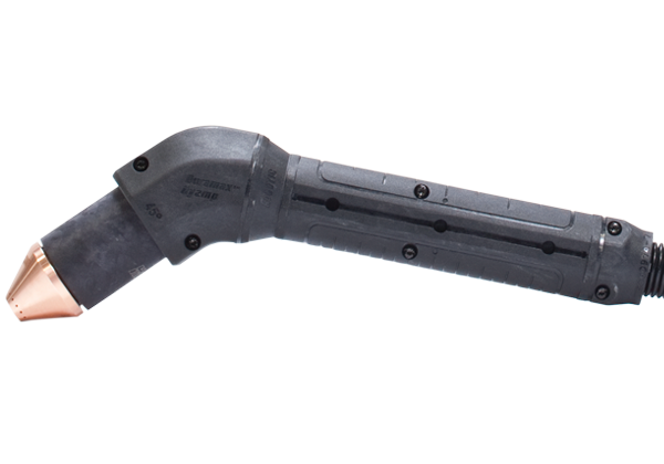

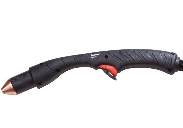

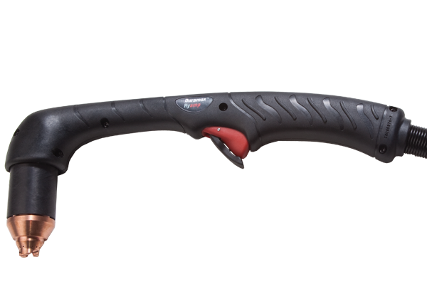

For hand cutting and gouging jobs
Duramax® Hyamp™ 85° and 15° hand torches are well suited for most hand cutting and gouging jobs. The ergonomic design of the 85° torch is perfect for normal cutting, while the 15° torch directs heat away from the operator during heavy gouging and enables cutting overhead or in hard-to-reach areas.

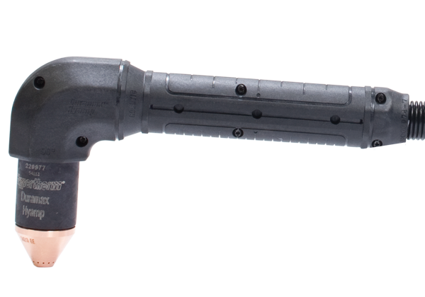

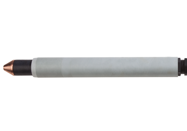

For machine jobs

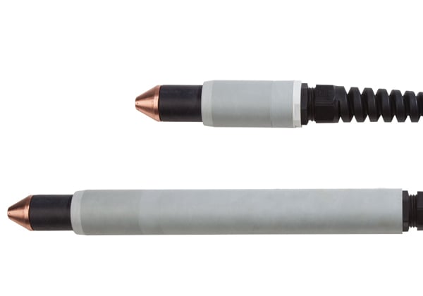

Duramax Hyamp 180°, full-length machine torches work with a wide variety of CNC cutting tables, track cutters, and pipe-cutters. Mini machine torches are perfectly suited for lighter tables and pipe cutting situations where the full-length torch is too long. Duramax Hyamp machine torches have a larger diameter and do not have a gear rack.

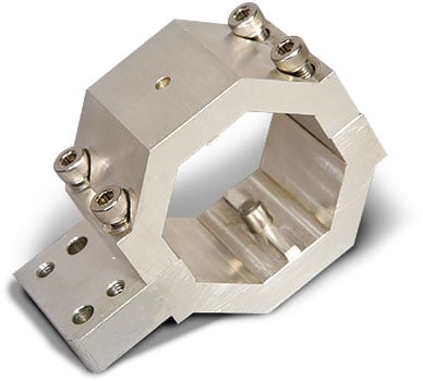

For robotic jobs

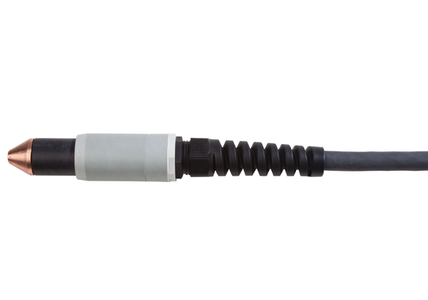

The light weight, small size and built-in positioning features of Duramax Hyamp robotic torches enable easy integration and operation with light robot arms. An optional clamp speeds integration.

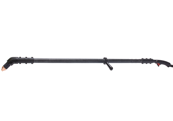

For heavy-duty applications

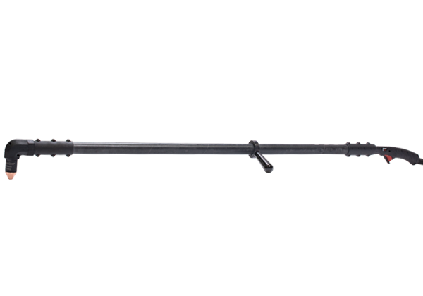

Duramax Hyamp Long torches offer extra reach and durability for heavy-duty applications like scrapping, plate skeleton removal from cutting tables, and infrastructure repair or reconstruction. .6 m (2’) and 1.2 m (4’) Long torches include a carry bag for storing the torch. The 1.2 m (4’) and 1.83 m (6’) Long torches include an adjustable position auxiliary handle.
