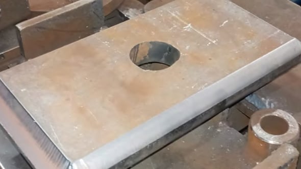

Cut part image

Bell Equipment's weld-preparation process had become a significant production constraint. To avoid slowing its XY plasma cutting tables, the company relied on an oxyfuel track burner for bevel cutting. Parts were manually positioned and rotated to create bevels on multiple sides, resulting in lengthy setup times and inconsistent throughput.
Some bevel-cutting work was outsourced to keep pace with demand, increasing both cost and lead time. Even with outsourcing, production delays persisted due to slow oxyfuel cutting speeds, extensive grinding requirements, and rework caused by bevel-angle inconsistencies and dross buildup.

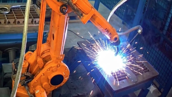

Deploying two robotic plasma cutting cells powered by Hypertherm technology
To eliminate the bottleneck and improve manufacturing efficiency, Bell Equipment developed two robotic cutting cells. One cell was equipped with a Hypertherm MAXPRO200® plasma system, while the second utilized a Hypertherm Powermax105® system. Learn more about robotic plasma cutting.
Each cell features three worktables, allowing operators to fixture up to 15 different parts at a time. This configuration supports continuous loading and unloading, maximizing equipment utilization and enabling higher production output.

By combining cutting and weld preparation into a single automated operation, Bell Equipment transformed a formerly labor-intensive process into a streamlined manufacturing workflow.
Compared with the previous oxyfuel process, robotic plasma cells:
  • Deliver more accurate bevel cuts
  • Operate 3 to 5 times faster than the previous process
  • Reduce grinding, cleanup, and other secondary operations
  • Produce many parts that are ready for welding immediately after cutting
