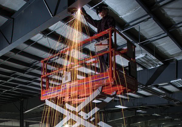

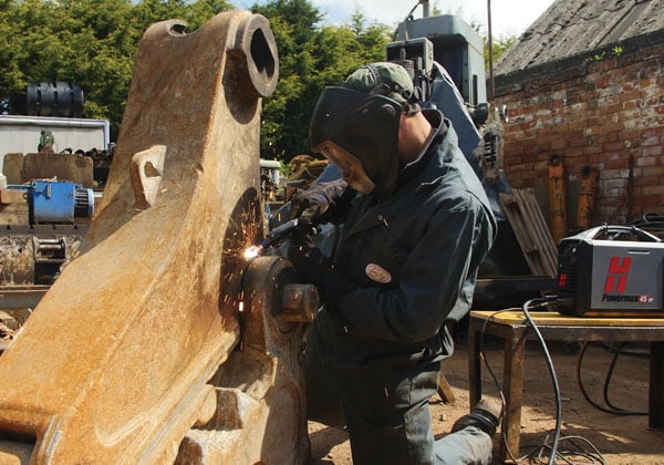

Out in the field, however, which metal cutting tools are most practical as jobs may take workers to remote locations, like in a mine or on a ship? HVAC contractors may be working on ladders, climbing into awkward spaces. Of course, manual tools are always an option: old-school metal snips, shears, and hacksaws can handle some lightweight metal cutting jobs, but the work is slow, and the cuts are typically crude. Portability is a key criterion. Early on, oxyfuel cutters were thought to be more practical for offsite work since they don’t require electrical power or an air compressor, as is the case with plasma cutters, and operate at almost any site.
However, technological advances have now made plasma cutting a standard, portable option. The new generation of plasma cutters has been designed for portability: they are lightweight but deliver enough power to cut through almost any metal. Now, having a lightweight and easy-to-set-up tool for beginners, portable plasma cutters are an essential tool for anyone working with metal. Also, the need for electrical power is not an issue on most job sites as engine-driven generators are commonly available.

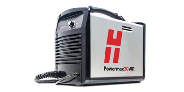

The Hypertherm Powermax® family of portable plasma cutting machines are great examples of lightweight tools that pack a powerful punch for a variety of applications. The 30-amp plasma cutter Powermax30 ® AIR takes portability a step further as it features a built-in air compressor which means workers only need a power source and the tool itself. Essentially, this dual voltage and portable 13.5 kg (30 lb.) plasma cutter can be operated anywhere and boasts the same advantages as its larger amperage siblings – superior cut quality, fast cutting speeds, low operating costs, a great multi-year warranty, and ability to cut a variety of metal types and cutting thicknesses.
