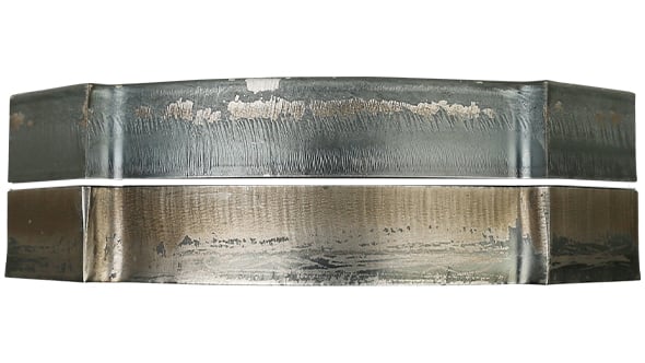

Plasma vs Laser side by side
If you’re thinking about purchasing a plasma cutter or fiber laser cutter, there are several factors in determining which cutting technology is best suited for your production environment, including capital investment, metal thickness, cut quality, and speed. Additionally, surface, maintenance, and operating costs should be considered. Depending on the job, plasma cutting and fiber laser cutting each offer advantages.

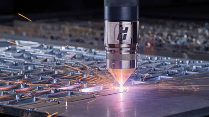

What is plasma cutting?
Plasma cuts through electrically conductive materials like steel, aluminum, and other conductive metals by creating an intense heat, ionized gas known as plasma, capable of melting and blowing away the cut material. This is typically achieved using a plasma torch that directs the high-velocity plasma electric arc onto the workpiece, resulting in precise and efficient metal cutting. Plasma cutting is a metal fabrication process commonly used in manufacturing, construction, and automotive industries for its speed and accuracy. Plasma cutting can be accomplished with handheld torches or using a computer numeric control (CNC) with a table for automated cutting.

Cutting Surface
Plasma delivers a surface finish that’s generally smoother than fiber laser in thicknesses over 16 mm (5/8″) and has consistent cut edge quality over the life of a consumable set.
Cut Quality
Plasma can achieve cut quality that rivals laser across mild steel, stainless steel, and aluminum.

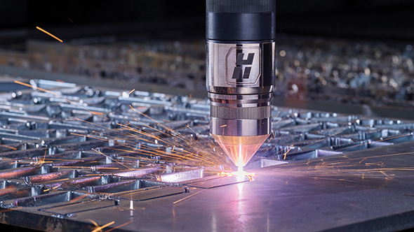

How X-Definition plasma changes the equation
The Hypertherm XPR®â€¯plasma family represents the most significant advancement in mechanized plasma cutting technology. X-Definition®â€¯technology significantly enhances the capability of Hypertherm plasma to deliver significant gains in cut quality on mild steel and expand the cutting outcomes on a broad range of stainless steel and aluminum applications.
Benefits of XPR plasma cutting systems
  • Industry-leading cut quality with X-Definition
  • Optimized productivity and lower operating costs
  • Engineered system optimization
