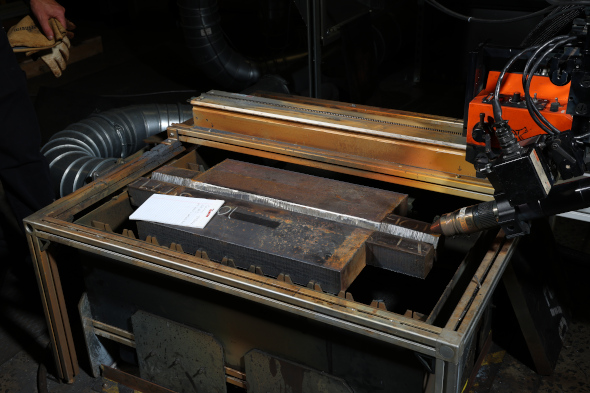

Image of plasma gouging setup
You see this wherever weld strength and inspection results matter, including shipbuilding, structural steel, pressure vessels, heavy equipment, railcars, wind towers, and energy infrastructure. These are the kinds of applications where Hypertherm Powermax®, MAXPRO200®, and XPR® systems can support anything from handheld repair work to mechanized and automated gouging.

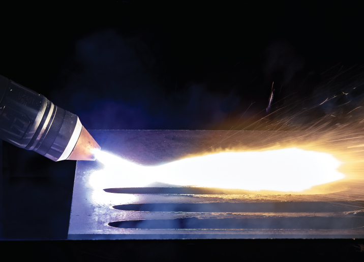

Taking metal out is only half the job. The shape of the gouge matters just as much.
A good back gouge gives the welder enough width and depth to reach the root without making the joint harder to weld. If the groove is too narrow, access becomes a problem. If it is uneven, the welder may have to grind and reshape the joint before welding can continue.
That is why consistency matters. Hypertherm plasma gouging can help create smoother, more repeatable profiles, which can mean less cleanup, less grinding, and less time between weld preparation and final welding.

A lot of back gouging is still done by hand. For that kind of work, Hypertherm Powermax systems are the natural fit because they give operators a portable platform for cutting, weld removal, repair, and gouging without adding another process to the shop floor. Powermax45 SYNC®, Powermax65 SYNC®, Powermax85 SYNC®, Powermax105 SYNC®, and Powermax125® can all support manual gouging work, depending on the material, joint size, and how much metal needs to be removed.
For lighter or more controlled work, Powermax systems with Max Control gouging cartridges and consumables can help operators shape the groove without taking out more base metal than needed. For faster metal removal, Max Removal gouging cartridges and consumables are a better fit, especially when the shop is opening the backside of a weld or removing a failed area before repair. When access is tight, HyAccess™ gouging cartridges and consumables give the operator more reach and visibility into the joint. A skilled operator can still adjust torch angle, travel speed, and removal rate as the joint changes, but the right Powermax system and consumable choice make that manual work easier to control.

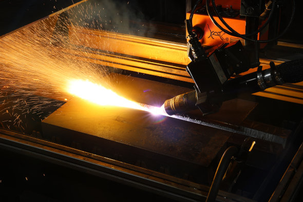

Automated Back Gouging
When the work repeats or there are long sections to backgouge, automation begins to make more sense. Long weld seams, heavy parts, and production environments benefit from a process that does not depend on one operator holding the same angle and speed for the full length of the joint.
Track-mounted systems, manipulators, robotic cells, and gantry systems can make gouging more consistent. With Hypertherm MAXPRO200 or XPR plasma systems, shops can support cleaner, more repeatable groove profiles in mechanized and automated back gouging applications.
back gouging action shot
There is a safety benefit too. Mechanized systems can move operators farther from the sparks, noise, fumes, and heat that come with weld preparation. For shipyards, pressure vessel shops, wind tower manufacturers, and structural fabricators, that can matter as much as the productivity gain.
