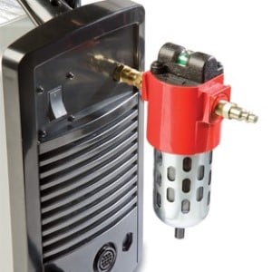

Hooking up the filter is easy. You can either install it on the back of your Powermax, just like you see in the photo above, or mount it on the wall with our custom wall bracket. This way, when you hook your air line up to this filter, you can ensure the air feeding to the plasma cutting system is dry and clean.

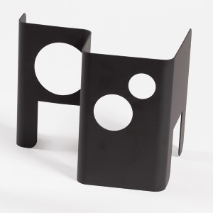

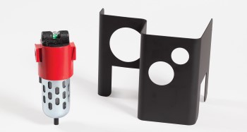

You can order this air filter kit by itself from an authorized Hypertherm distributor. The part number is 128647. Hypertherm also sells the filter in a kit with a protective steel guard (shown below) that protects the filter from getting knocked out of place. You can also purchase this guard separately if you already have the filter. These part numbers can be found on our website.
Lastly, keep in mind that for your filter to work, you’ll need to routinely change out the 1-micron filter element inside it. The sight glass on-top of the filter unit will change from green to red, signaling it’s time to do that. Replacing the element is easy. Unscrew the filter bowl, take out the old filter element, and replace it with a new one. Then screw the bowl back into place. The part number for a replacement filter element is 011092.
