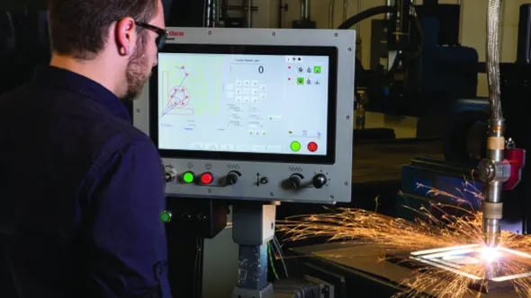

X-Y-Z cutting and gouging
X-Y-Z cutting and gouging, often called XY cutting, is the use of a table equipped with a computer numeric control (CNC) for rapid and precise cutting of flat plate. The CNC moves the torch along the X and Y axes, while a height control system regulates the Z, or up and down motion, keeping the torch or cutting head at an optimum distance from the plate.
Though people often think of a CNC plasma, sometimes called a computer plasma cutter, you do not necessarily need to use plasma. Laser, waterjet, and oxyfuel are also suitable processes.
Whether you choose to use a plasma CNC machine or not, these tables are available in a wide range of sizes and prices.
The smallest use a standard personal computer as the CNC (CNC plasma cutting machine, laser, waterjet, or oxyfuel) and can be as small as 2′ by 2′. How to choose a small CNC plasma cutting table.
High-performance industrial CNC plasma cutting tables (or waterjet, laser, and oxyfuel) can be as long as 100′ and often have multiple torches mounted on one or more gantries for mass production and fabrication.

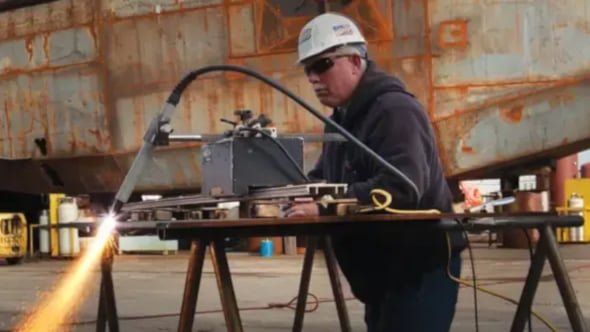

Straight track cutting and gouging
Track cutting and gouging is used to make long, straight cuts or gouges that are difficult and time-consuming to do by hand with the necessary precision. Straight rack cutting is sometimes used on a job site when the material to be cut or gouged is of a size or shape not suited to an X-Y table. Automating these processes with a portable track burner increases productivity and results in a more uniform cut or gouge. Although originally designed for use with oxyfuel torches only, many suppliers now produce straight track burners capable of delivering the high speeds needed when cutting with plasma.

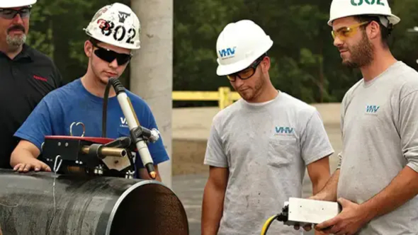

Pipe and tube cutting
Rotary pipe and tube cutting capability is now commonly available via both stand-alone machines and as part of an add-on option for X-Y cutting tables. These machines offer the ability to mount pipe and tube sections and cut profiles from the pipe or tube wall. Extremely accurate profiles can be cut using exterior dimensions, wall thickness, rotational motion, and other required factors, ensuring ease of fit-up prior to welding, or simply for aesthetic or architectural purposes. Advanced programming even makes it possible to include bevel angles to assist with weld preparation.

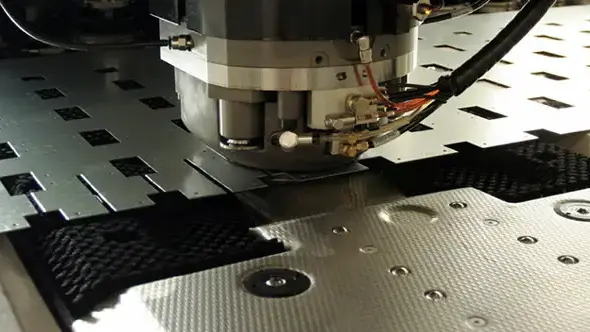

Punch processing
Punch processing of flat sheet or plate is commonly performed using one of two machine formats. First, stand-alone punch machines, known as turret punches, offer automated operations including punching, contour cutting (nibbling), and tapping. Because of their versatility, turret punch machines are highly effective as punch processing tools. The process delivers highly accurate holes, without exposing workpieces to damage from heat-affected zones.
A second machine format integrates punch capability into an X-Y plasma cutting system, laser, or plate processing machine. By bringing these processes together, fabricators can enjoy superior productivity thanks to reduced material handling time and improved part quality. In addition, these integrated machines save on floor space.
Combination plasma/punch and combination laser/punch typically feature a traditional cutting table with the added ability to reposition the workpiece to a dedicated punching station. (These machines are sometimes referred to as reposition machines.)
Plate processing machines combine cutting, punching, drilling, and other tools in one highly versatile machine.
