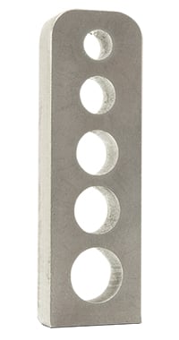

Beyond edge angularity, XPR® and X-Definition® attacked the issue of hole quality. Whereas, older plasma systems delivered holes with tapered sides and protrusions inside the hole, True Hole® using an X-Definition plasma process on XPR is capable of delivering bolt quality holes on mild steel with diameter to thickness ratios ranging from 2:1 to 1:1. Compared with earlier non-X-Definition True Hole, full cylindricity measurements and bottom-of-hole roundness have been improved.
True Hole on XPR delivers superior plasma cut holes from a thickness to diameter range of 2:1 to 1:1, as depicted here. Cylindricity and bottom hole roundness have been improved over non-X-Definition True Hole.

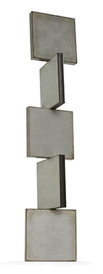

On thicker stainless steel, when using discretely mixed H2-Ar-N2 as the plasma gas and an N2 shield, X-Definition plasma processes will produce stainless steel cuts that are typically in ISO range 3 or 4, typified by bright, smooth edge finishes, no dross and good perpendicularity. The X-Definition discrete gas mixing capability also allows the user to modify the gas mix to optimize results for different grades of stainless steel.
 Discrete 3-plasma gas mix (H2-Ar-N2) with an N2 shield provide excellent cuts on thicker stainless steel, 12 mm (1/2”) and thicker. Edges are smooth, shiny and either neutral in color or slightly gold-toned (higher mix of Ar). Cuts are essentially dross free and perpendicularity typically ranges from ISO range 3 to 4.

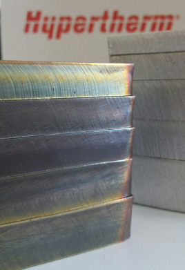

And finally, using a new X-Definition N2/H2O (nitrogen plasma and water shield) process called Vented Water Injection™ (VWI), the XPR300 can generate results on aluminum that are truly remarkable compared to earlier generation plasma cutting.
The aluminum stack shows X-Definition’s VWI process delivering exceptionally smooth cut surfaces, with low angularity (ISO range 3 to 4) with no dross across a variety of thicknesses.

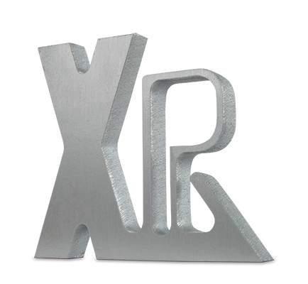

These two samples show its ability to deliver fine features, including interior slots and holes, on thinner aluminum.
