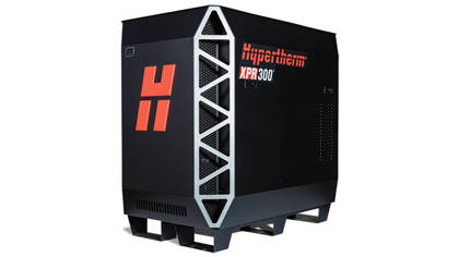

Hypertherm’s X-Definition plasma, found in the XPR300™ represents the most significant advance in plasma cutting technology ever.  The system offers unmatched cut quality on mild steel, stainless steel and aluminum, increased cut speed, dramatically improved productivity and a 50% operating cost reduction. In addition, new ease-of-use features and engineered system optimization make the XPR300 easier to run with minimal operator intervention, while also ensuring optimal performance and reliability. The XPR family also includes 170 and 460 amp versions with the same X-Definition features.
