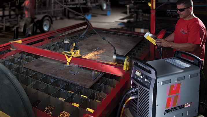

Start with an air plasma system
Air plasma systems, like our Powermax® systems, are nearly always used for entry-level CNC tables because air plasma systems are the most economical option for these tables. Make sure the plasma you buy has a blowback start (nearly all newer systems do) rather than a high-frequency start.
Plasma cutters that rely on high-frequency AC voltage to start the plasma stream radiate a significant amount of electromagnetic interference that interferes with the PC-based machine control and electronics. Blowback start plasma cutters produce significantly less electromagnetic interference and can be used around CNC microcontrollers and electronics that have not been engineered to withstand high levels of electrical noise.
While a system with a blowback start has a slightly higher upfront and maintenance cost, this fee is significantly less than purchasing a CNC table that is hardened to electromagnetic interference.
