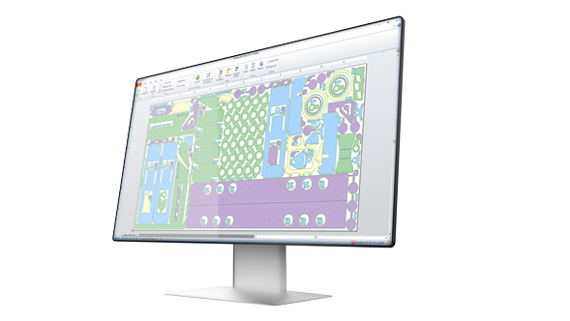

Image of nesting software

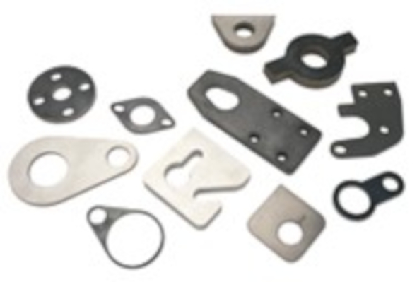

  5. image of filler partsUse filler parts
    After the primary job(s) have been nested, you may still have extra space left on the nest. One way to utilize the remaining plate is by adding commonly cut filler parts, or stock parts that could be cut now and placed into inventory for later use. These are common manufacturing processes in the industry, but there are different ways to go about it, some fabricators stock up on parts that they know they’re going to get frequent orders for, others have received huge orders for small parts, which they then try to fit on other jobs, knocking out one batch at a time.
