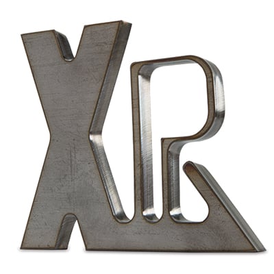

What kind of cut quality should I expect when plasma cutting stainless steel?
 It is possible to produce plasma-cut stainless steel parts with excellent quality. Hypertherm’s X-Definition™ plasma process in particular is capable of producing parts with smooth, sharp edges that require minimal or no rework at all; a neutral and shiny surface finish; and very little to no dross. The cut quality you personally achieve will depend on a number of things such as gas selection, the type of plasma cutter you have, the quality of your cutting table, and the exact cut parameters you use.

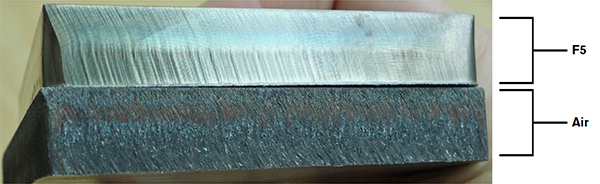

If you have an air plasma cutter like a Powermax®, you have three potential gas choices when plasma cutting stainless steel: air, nitrogen, and F5. Using clean, dry air as your plasma and shield gas is the easiest, fastest, and most economical way to plasma cut stainless steel with an air plasma system. There is a one drawback to using air however: Oxides will form on the cut edge creating a rough, dark gray finish. To lessen oxidation, you can either submerge the stainless steel material you are cutting underwater or use nitrogen instead of air. The downside to nitrogen when plasma cutting stainless steel is that it is more expensive process and will result in more dross. F5 can be used to plasma cut stainless steel with some Powermax system and torch combinations. The use of F5 will leave you with a shiny, silver colored finish (photo below) however, this process is more expensive than other methods and requires that you use a slower cut speed.
No matter which process you use when plasma cutting stainless steel – air, nitrogen, or F5 – it is possible to achieve good – though not excellent – cut quality using an air plasma system. Cut parts will always have some angularity, top edge rounding, and surface imperfections.

Cutting stainless steel greater than 5 mm (0.188″) but less than 12 mm (0.5″) in thickness
When plasma cutting mid-range stainless steel, we recommend the use of F5 as the plasma gas and nitrogen as the shield gas. This combination will provide the best combination of cut quality, cut speed, and operating cost. Cut parts will have a sharp top edge, very little angle variation, and a shiny metallic surface finish.
