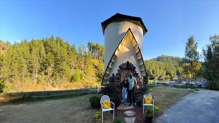

A: Yes, we work with both residential and commercial customers, which has been great. My company started working mostly in the residential space, and I developed skills and collected tools like plasma cutters, and other specialty tools that made it possible to expand my skill set. We started to dip our toe into commercial projects, where people would call and want some custom feature piece or unique build out. These projects gained enough attention that we were pursued by numerous production companies, eventually landing us our own TV show on the Magnolia Network (also streaming on Max and other popular platforms) called Building Outside the Lines. My 16-year-old stepdaughter is the co-host of the show, and we turn things that were once junk into something amazing. For example, we did a big project with a 24-foot-tall steel water tank from the oil field, which we cut down using the plasma cutter and turned into a two-story art studio, complete with HVAC and Wi-Fi.
