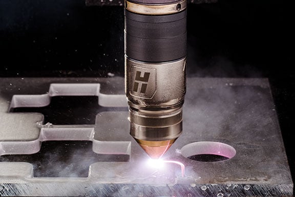

Why aluminum is well suited for plasma cutting
Plasma cutting uses a high velocity jet of ionized gas to melt electrically conductive metal and eject it from the kerf, a process refined across Hypertherm systems.. Aluminum is electrically conductive, so it is inherently compatible with plasma cutting.
The practical advantage is productivity, especially when using Hypertherm plasma systems designed for consistent output. Plasma can deliver high travel speeds on aluminum sheet and plate while maintaining edge quality that works for many fabrication workflows.In automated environments, Hypertherm plasma systems support repeatability by keeping torch height, speed, and sequencing consistent across long production runs.

Dialing in the cut: the variables that matter most
Amperage and travel speed are linked
Amperage provides cutting power. Travel speed controls heat input. These two variables have to move together.
Common failure modes are predictable:
  • Too slow: excessive heat input, wide kerf, heavy bottom edge dross, distortion
  • Too fast: incomplete penetration, bevel, arc instability, spatter
A practical tuning approach is to start at the validated speed, then adjust in small increments until dross is minimized and the edge profile stabilizes. Avoid large swings. If you need large swings, the process selection is likely wrong for the thickness or finish target.
