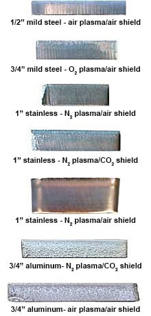

Do plasma cutters use gas? Yes. All plasma cutting systems—including air plasma cutters—use gas. In addition to using one type of gas, many fabricators choose plasma systems with “dual-gas” or “multi-gas” capability. This means that a variety of plasma and shield gases can be used for various applications. Multi-gas torches offer the most flexibility for shops that cut a variety of materials. Different gases are used, depending on material type and thickness, to achieve the best balance of cut quality, consumable life, productivity, and overall cost of operation. Most plasma system manuals tend to overwhelm the operator with a confusing array of cut charts and gas choices. The intent of this article is to provide a brief overview of the advantages and disadvantages of each gas and make "best case" recommendations for cutting the three most common materials: mild steel, stainless steel and aluminum.

The best gas to use depends, mainly on three considerations: cut quality, productivity, and economy.
- For mild steel, use an oxygen plasma gas and air shield gas for the best, clean cut quality, lowest dross levels, minimal rework, excellent weldability and highest cutting speed/productivity.
- For best cut quality on stainless and aluminum under 1/2″ use nitrogen plasma and air secondary for a good balance of cut quality and affordability. For a slightly better and faster cut, use CO2 as the secondary. If your system allows, water shield will provide the best edge quality.
- For best cut quality on thick stainless and aluminum use argon-hydrogen with nitrogen secondary. WARNING: your system must be equipped for safe operation with argon hydrogen gas.
- For the most economical cutting, clean dry shop air is the best choice for cutting aluminum, mild steel, and stainless.
