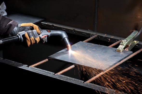

Gouging with a handheld plasma torch
The most common gouging technique involves positioning the torch at an angle to the workpiece, while the pilot arc is formed and transferred to the plate. Once contact is made, the operator aims or feeds the arc in the direction they want to gouge.
1. Hold the plasma cutter torch so that the nozzle is within 1.5 mm (1/16") from the workpiece before firing the torch.
2. Hold the torch at a 40 angle to the workpiece with a small gap between the torch tip and the workpiece. Press the trigger to obtain a pilot arc. Transfer the arc to the workpiece.
3. Maintain an approximately 40-degree angle to the workpiece as you move the torch along the workpiece, pushing the plasma arc in the direction you want to create the gouge. Keep a small distance between the torch tip and the molten metal to avoid reducing consumable life or damaging the torch.

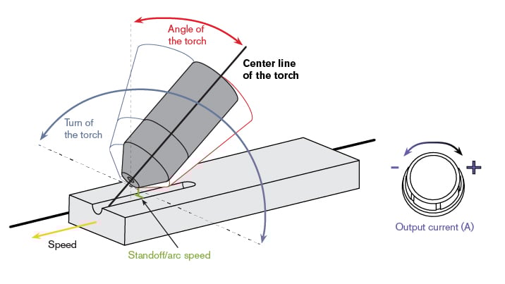

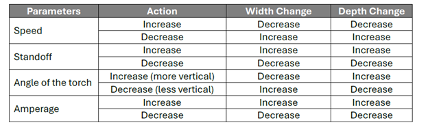

In general, you can change the gouge profile and the metal-removal rate by changing the speed of the torch as it moves along the workpiece, the distance between the torch and the workpiece, the angle of the torch to the workpiece, and the output current (A) of the plasma power supply. A summary of the effects of each is:
The following factors are the main “levers” available within a plasma arc gouging installation that affect gouge depth. While there are starting points for all parameters, there will likely be experimentation with each of these factors to get the desired results for a specific application.

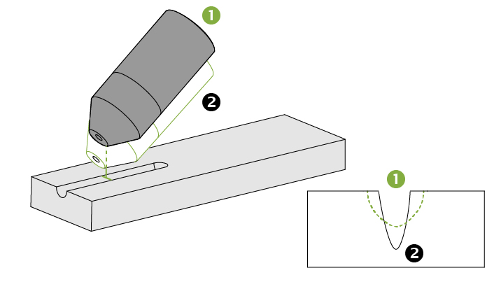

Torch height
Torch height governs the “arc stretch” or “arc shape” required to produce a smooth curved gouge profile. Note that arc stretch is also related to the amperage of the plasma power supply (covered below), in that the higher the amperage, the longer you can stretch the arc. Use torch height and amperage in unison to shape the gouge profile as desired. There should always be a small distance between the torch tip and the molten metal to increase consumable life and prevent damage to the torch, although this distance varies by system and amperage.
Move the torch away from the workpiece to make the gouge wider, shallower, and smoother on the bottom (1). Move the torch closer to the workpiece to make the gouge narrower and deeper (2).
Torch height effect on gouging profile

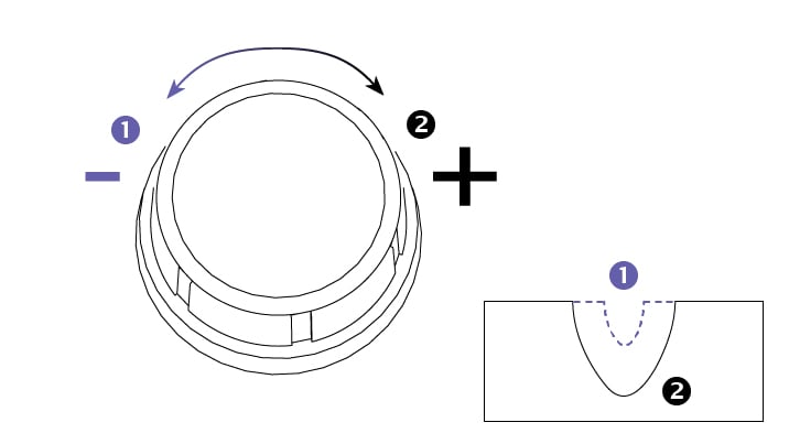

Amperage
Amperage has a significant influence on gouge depth and is the easiest, most controllable change to make. In addition, amperage of the plasma power is also related to arc stretch supply – the higher the amperage, the longer that you can stretch the arc. Use torch height (covered above) and amperage in unison to shape the gouge profile as desired. Decrease the amperage to make the gouge narrower and shallower (1). Increase the amperage to make the gouge wider and deeper (2).
Power supply amperage effect on gouging profile
Travel speed
The travel speed of the workpiece and/or torch has a straightforward relationship to gouge depth. When reducing travel speed, however, slag management becomes important as the arc can “dig in”, producing more slag that adheres to the workpiece. Increase the torch speed to make the gouge narrower and shallower (1). Decrease the speed of the torch to make the gouge wider and deeper (2).
Travel speed effect on gouging profile

Turn of the torch
Also known as Transverse Angle or Offset Angle. Torch turn, typically 3° to 5°, influences gouge width and shape when gouging in a straight line. Torch turn also assists in slag removal from the groove but can create a non-symmetrical groove if angle is too great. Turn the torch relative to the torch center line to make the gouge flatter and steeper on one side (1). The gouge profile will be flatter/steeper on the side nearest the direction that the torch body is turned.
Torch turn effect on gouging profile
